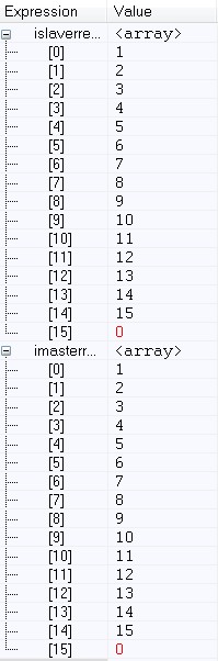

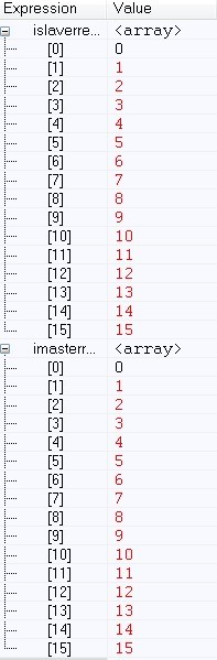

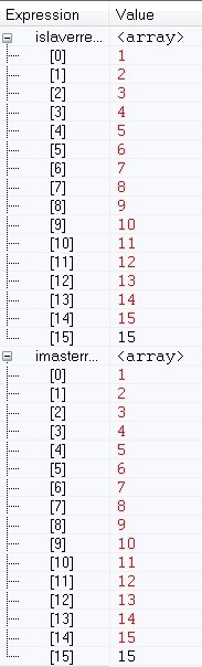

TiM4123 MCU 两串口收发数据奇怪现象,程序出现了什么问题?
您好: 我把lanchpad 的Uart5和Uart7收发短接起来,测试收 发,主要程序如下。
#define MASTERUARTBASE  UART7_BASE
#define SLAVERUARTBASE  UART5_BASE
#define UARTBAUD  115200
unsigned int imasterrevdat[16];
unsigned int iindexm = 0;
unsigned int islaverrevdat[16];
unsigned int iindexs = 0;
void
PortFunctionInit(void)
    MAP_SysCtlPeripheralEnable(SYSCTL_PERIPH_UART5);
    MAP_SysCtlPeripheralEnable(SYSCTL_PERIPH_UART7);
    MAP_SysCtlPeripheralEnable(SYSCTL_PERIPH_GPIOE);
    MAP_GPIOPinConfigure(GPIO_PE5_U5TX);
    MAP_GPIOPinTypeUART(GPIO_PORTE_BASE, GPIO_PIN_5);
    MAP_GPIOPinConfigure(GPIO_PE4_U5RX);
    MAP_GPIOPinTypeUART(GPIO_PORTE_BASE, GPIO_PIN_4);
    MAP_GPIOPinConfigure(GPIO_PE0_U7RX);
    MAP_GPIOPinTypeUART(GPIO_PORTE_BASE, GPIO_PIN_0);
    MAP_GPIOPinConfigure(GPIO_PE1_U7TX);
    MAP_GPIOPinTypeUART(GPIO_PORTE_BASE, GPIO_PIN_1);
    MAP_UARTConfigSetExpClk(MASTERUARTBASE, MAP_SysCtlClockGet(), UARTBAUD,
                            (UART_CONFIG_WLEN_8 | UART_CONFIG_STOP_ONE |
                             UART_CONFIG_PAR_NONE));
    MAP_UARTConfigSetExpClk(SLAVERUARTBASE, MAP_SysCtlClockGet(), UARTBAUD,
int
main(void)
    unsigned int i = 0;
    SysCtlClockSet(SYSCTL_SYSDIV_4|SYSCTL_USE_PLL|SYSCTL_XTAL_16MHZ|
                    SYSCTL_OSC_MAIN);
    PortFunctionInit();
    MAP_IntMasterEnable();
    MAP_IntEnable(INT_UART5);
    MAP_UARTIntEnable(SLAVERUARTBASE  , UART_INT_RX | UART_INT_RT);
    MAP_IntEnable(INT_UART7);
    MAP_UARTIntEnable(MASTERUARTBASE  , UART_INT_RX | UART_INT_RT);
    while(1)
      for(i = 0;i<=0xF;i++)
          while(!UARTCharPutNonBlocking(MASTERUARTBASE  ,i));
          SysCtlDelay(SysCtlClockGet() / (500 * 3));
          while(!UARTCharPutNonBlocking(SLAVERUARTBASE  ,i));
void MasterReceiveIsr(void)
    uint32_t ui32Status;
    ui32Status = MAP_UARTIntStatus(MASTERUARTBASE, true);
    MAP_UARTIntClear(MASTERUARTBASE, ui32Status);
    while(MAP_UARTCharsAvail(MASTERUARTBASE))
        imasterrevdat[iindexm++] = MAP_UARTCharGetNonBlocking(MASTERUARTBASE);
void SlaverReceiveIsr(void)
    ui32Status = MAP_UARTIntStatus(SLAVERUARTBASE, true);
    MAP_UARTIntClear(SLAVERUARTBASE, ui32Status);
    while(MAP_UARTCharsAvail(SLAVERUARTBASE))
        islaverrevdat[iindexs++] = MAP_UARTCharGetNonBlocking(SLAVERUARTBASE);
第一个循环
第二个循环
以后的几次循环
请指点一下,怎么会这样?哪里出现问题了,
