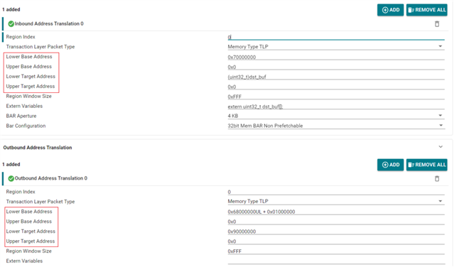

你好:请问除了AM243Xx的Technical Reference Manual,还有没有其他关于PCIE的资料?
抱歉回复晚了,请看下面e2e工程师的回复。
Sorry for the delay in the response. Digging further on your question, the address space 0x70000000 is corresponding to MSRAM_256K0_RAM in the Table 2-1 of TRM. My understanding is that the ATU space is mapped to this RAM in the PCIe example you pointed out. I believe this address can vary based on the implementation of the software. Please let me know if this answers your question.
