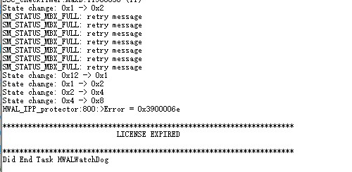

When  we run the EtherCAT demo  ,an hour later,it shows :EVAL VERSION EXPIRED.We need to lift the restriction.

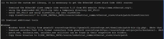

So we recompiled the SSC according to the following documentation,Using SSC V5i13 to recompile ethercat slave library.
Rebulid the project,and download to the board.Power on ,run the EtherCAT program,after few minutes,it shows:LICENSE EXPIRED.
What causes this problem?How to lift the limit?
