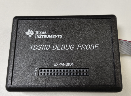

自己按ti推荐的设计做的双芯片级联(AM273X + 2xAWR2243 EVM)硬件,仿真器用的这个XDS110 ,请问如何用LVDS采数;
  •  XDS110测试test connect ,出现错误是啥原因

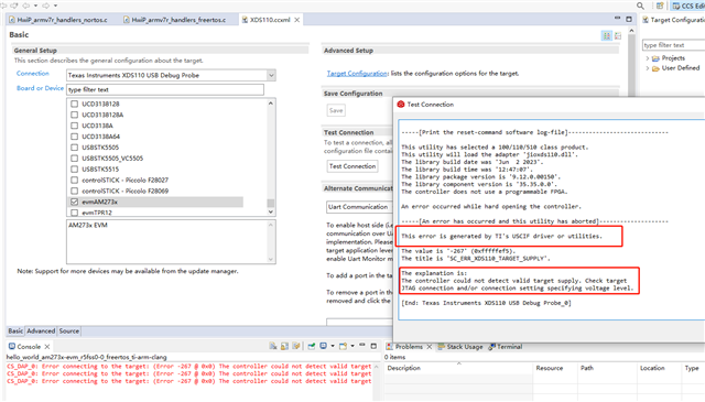

  • 我的目的是要双芯片级联(AM273X + 2xAWR2243 EVM)硬件采数,但按文档的描述LVDS采数需要用CCS DEBUG加载固件,接着我就购买了XDS110 调试探针,XDS110 test connect打印这些:
    [Start: Texas Instruments XDS110 USB Debug Probe_0]
    Execute the command:
    %ccs_base%/common/uscif/dbgjtag -f %boarddatafile% -rv -o -S integrity
    [Result]
    -----[Print the board config pathname(s)]------------------------------------
    C:\Users\LENOVO\AppData\Local\TEXASI~1\CCS\
    ccs1240\0\0\BrdDat\testBoard.dat
    -----[Print the reset-command software log-file]-----------------------------
    This utility has selected a 100/110/510 class product.
    This utility will load the adapter 'jioxds110.dll'.
    The library build date was 'Jun 2 2023'.
    The library build time was '12:47:07'.
    The library package version is '9.12.0.00150'.
    The library component version is '35.35.0.0'.
    The controller does not use a programmable FPGA.
    An error occurred while hard opening the controller.
    -----[An error has occurred and this utility has aborted]--------------------
    This error is generated by TI's USCIF driver or utilities.
    The value is '-267' (0xfffffef5).
    The title is 'SC_ERR_XDS110_TARGET_SUPPLY'.
    The explanation is:
    The controller could not detect valid target supply. Check target
    JTAG connection and/or connection setting specifying voltage level.
    [End: Texas Instruments XDS110 USB Debug Probe_0]
    不知是不是新买的XDS110仿真器有问题
