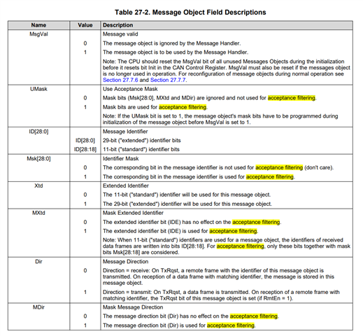

while ((canREG1->IF2STAT & 0x80U) ==0x80U)
} /* Wait */
for(i = 33U; i <= 64U;i++){
canREG1->IF2MSK = 0xC0000000U | (uint32)((uint32)((uint32)0x1FFFFFFFU & (uint32)0x1FFFFFFFU) << (uint32)0U);
canREG1->IF2ARB = (uint32)0x80000000U | (uint32)0x40000000U | (uint32)0x00000000U | (uint32)((uint32)((uint32)i & (uint32)0x1FFFFFFFU) << (uint32)0U);
canREG1->IF2MCTL = 0x00001000U | (uint32)0x00000400U | (uint32)0x00000000U | (uint32)0x00000000U | (uint32)8U;
canREG1->IF2CMD = (uint8) 0xF8U;
canREG1->IF2NO = i;
请问是在这里配置吗,具体配置哪些寄存器和哪些位
