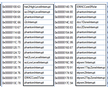

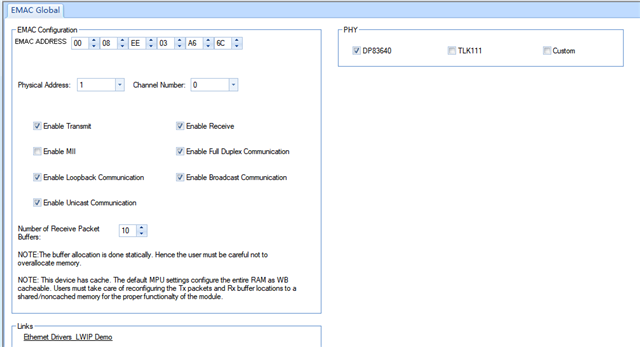

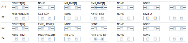

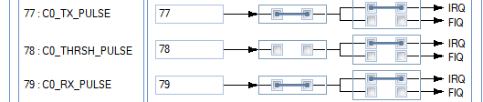

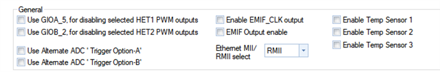

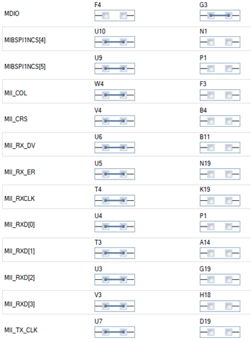

TMS570LC4357: We have adopted the RMII mode circuit design for the Ethernet interface from the TMS570LC4357 HDK development board. However, we are unable to ping the computer host.
Part Number: TMS570LC4357
We are using the official software version v00.04.00, and the configuration in the HCG is as follows:
1、Pin Muxing
2、Input Pin Muxing
3、Special Pin Muxing

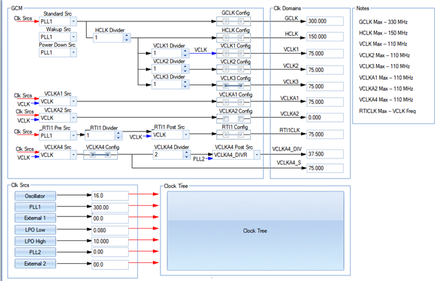

4、EMAC Configuration

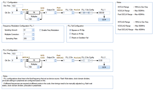

5、VIM Channel 64-95
6、VIM RAM
7、GCM
8、PLL
May I ask if there are any errors in the configuration on the HCG?
