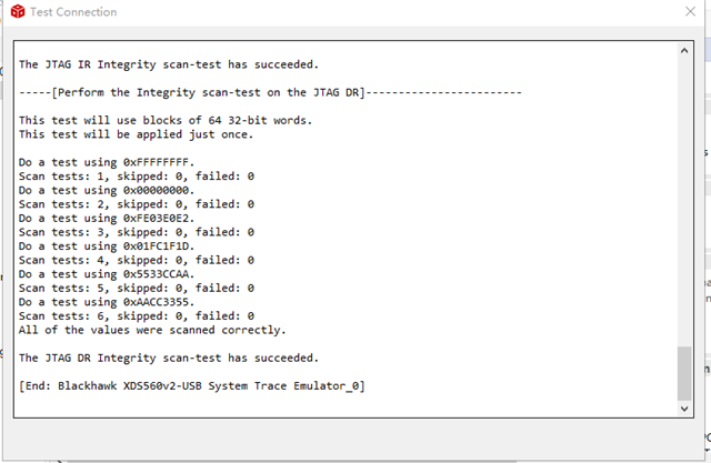

错误如下图:
谢谢您的回复,新出现的问题如下,设计的板子没有用PMIC供电,直接外接3.3v、1.8v、1.2v的电源,请问电源的上电时序会造成这个问题吗?和gel文件有关系吗?
Cortex_R5_0: Trouble Writing Memory Block at 0x0 on Page 0 of Length 0x40: (Error -1065 @ 0x0) Unable to access device memory. Verify that the memory address is in valid memory. If error persists, confirm configuration, power-cycle board, and/or try more reliable JTAG settings (e.g. lower TCLK). (Emulation package 9.12.0.00150)
Cortex_R5_0: File Loader: Verification failed: Target failed to write 0x00000000
Cortex_R5_0: GEL: File: D:\AWR2243\work_space\mss_cascade_r5fss0-0_freertos_ti-arm-clang\Debug\mss_cascade_r5fss0-0_freertos_ti-arm-clang.out: Load failed.
