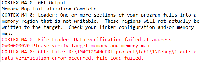

TM4C129encpdt开始可以烧写程序,后来就不能了,并且RST低电平 芯片不能复位。
问题找到了,晶振虚焊的原因。现在RST能复位了,程序能烧写了。

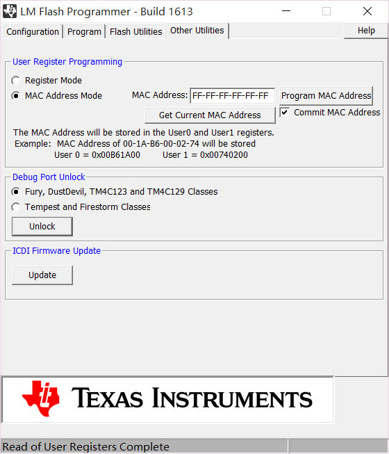

It is possible to run code on a Tiva C Series device that causes the device to lose JTAG communication. The two most common causes are:
If you accidentally do either of these things, you can restore communication with your target device by running the Debug Port Unlock utility in LMFlash Programmer as shown below. For Tiva devices, select the Fury, DustDevil and Blizzard option
On TM4C129x devices, the MAC address is erased by the Debug Port Unlock utility, so be sure to write down the number before running the utility.

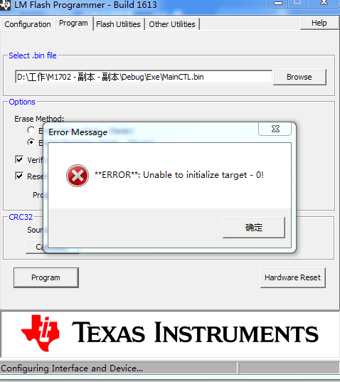

好吧,原来是这个问题。程序不能烧写,一般就是晶振和复位问题,如果使用内部晶振的话,只有复位的问题了。
解决就好,学习了。有个建议,尽量不要把工程放在中文的路径下,有时会有不可知的错误。
