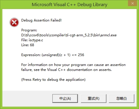

用ccsv6 build TM4C123GH6PM的样例工程时出错
Other Parts Discussed in Thread: TM4C123GH6PM
如图,应该是c++ compiler设置的问题?求解啊,新手
example里的工程,程序应该没什么问题
  • 看样子应该是你VC组件的问题,电脑没装好。下个VC++运行库试试。
  • 我装了vc++ 2013运行库还是不行啊,一样的错误,ccs提示的组件更新我也都更了,具体错误提示是下面这样的
    INTERNAL ERROR: D:/ti/ccsv6/tools/compiler/ti-cgt-arm_5.2.5/bin/armcl had an internal inconsistency and aborted
    while processing file ../tm4c123gh6pm_startup_ccs.c
    This is caused by a defect in the compiler itself. TI Customer
    Support may be able to suggest a workaround to avoid this.
  • This is caused by a defect in the compiler itself. TI Customer
    这是由于编译器本身的缺陷。这是什么问题呢,我没出现过这个情况。你把CCS和TIVA 开发包装c盘根目录下,装最新的CCS6.1试试,不行重装系统
  • 看起来是电脑的原因,谢谢回答~
    换了linux~可以make
