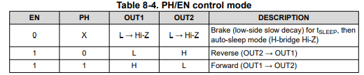

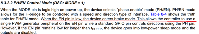

DRV8210: Why can EN control the speed of the motor when the PH/EN control mode?
Part Number: DRV8210
Why can EN control the speed of the motor when the PH/EN control mode? I do not see this conclusion in the table given.
