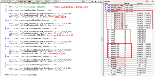

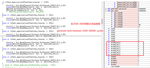

    1. DRVOFF pull-down → Fault generation → Clear the fault once in the 3004th cycle: No fault can be read after 3004th cycle

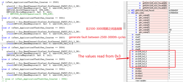

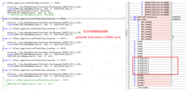

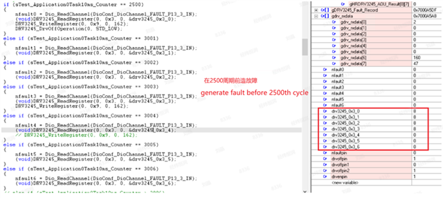

    2. Fault generation → drvoff pull-down → clear fault once: no fault can be read again after 2500th cycle

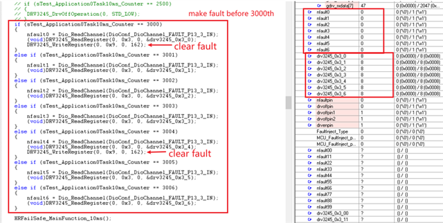

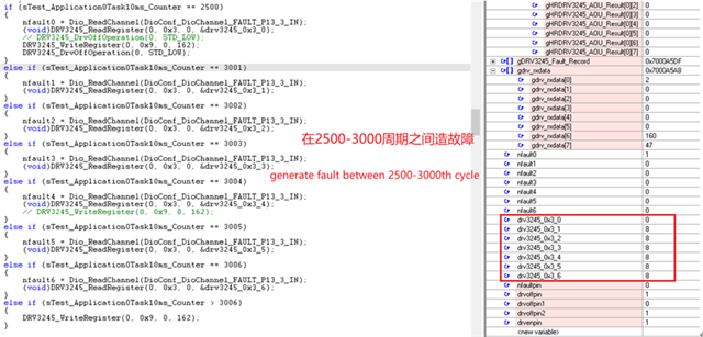

    3. Fault generation → clear fault once → drvoff pull-down → clear fault once in the 3003th cycle: no fault can be read again after 3003th cycle
    4. Fault generation → clear the fault once → drvoff pull-down → clear the fault after 3006th cycle: no fault can be read after 3006th cycle
    5. Drvoff pull-down → fault generation → clear the fault after 3006th cycle: no fault can be read after 3006th cycle

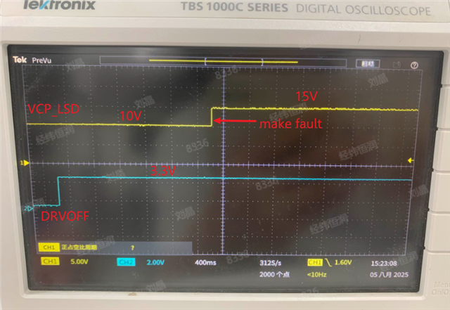

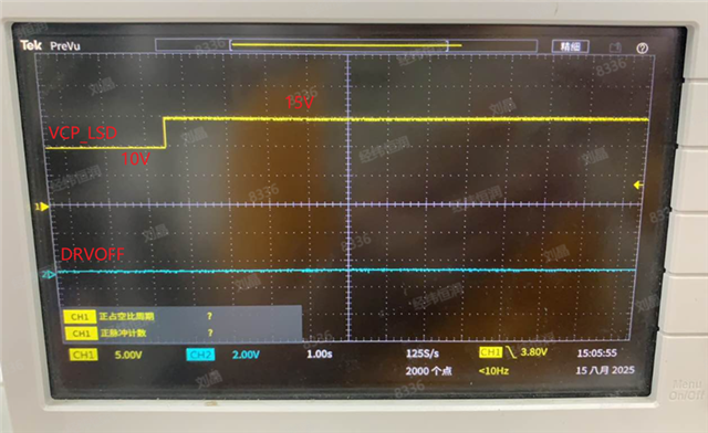

  • These two graphs are data that occurred at the same time. The upper graph shows the voltage changes of VCP_LSD and DRVOFF, while the lower graph shows the values read from the register 0x3. If you cannot understand the code of the second graph, please find someone who can understand it.

    Can you share waveform of the DRVOFF, VCP_LSD, and GH/GL so that we can review?

    I did force the VCP_LSD pin to 15V through an external power supply, and it consistently displays 15V. The image in my previous comment can illustrate this.

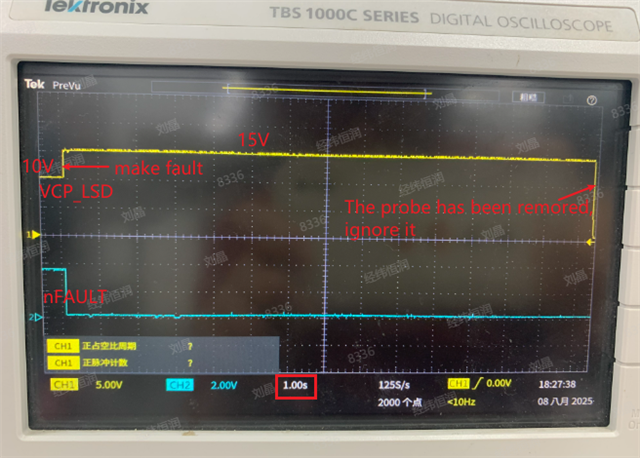

    Since the variable is incremented by 1 after every 10ms, then there is 5 seconds between DRVOFF going high and the readback of the fault register and then shortly after that sending a clear fault command. Based on the waveform you provided, based on the scope division the time at which the clear fault is sent happens at a much later time compared to the time of the scope capture. With this in mind, I want to confirm that the overvoltage is still present when the clear fault is issued since the previous waveform doesn't show the state of the VCP_LSD pin voltage at the time of the clear fault command. One way to capture this is to have a GPIO on the MCU toggle when the clear faults command is sent, and then set the scope to trigger on that GPIO while probing nFAULT and VCP_LSD along with the GPIO.

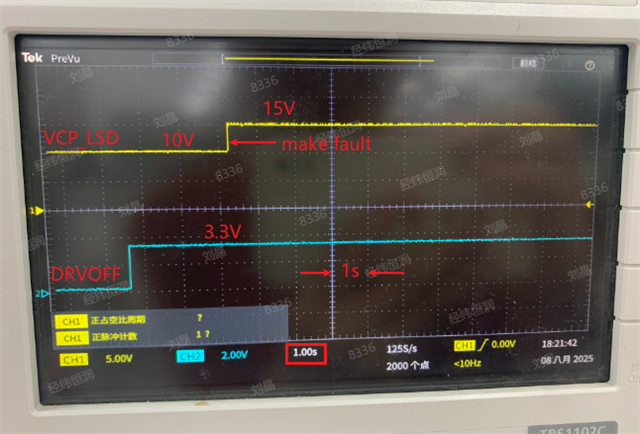

  • Thank you for your reply. As our oscilloscope only has two channels and cannot display the status of VCP_LSD, DRVOFF, and nFAULT simultaneously, I have tested it twice.
    As shown in the above figures, I have marked the time scale, with each square representing 1 second. I believe this time span can answer your question. The value read from the register is the same as my previous comment.
  • Thank you for your confirmation that the VCP_LSD OV condition is still present even after giving a clear fault command. Regarding my other questions:

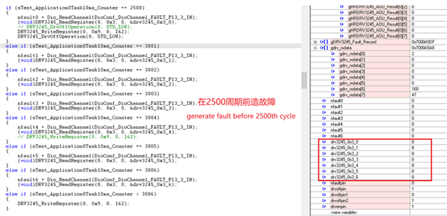

  • 1. For your question one, I modified the code and conducted testing.
     If DRVOFF is low, the VCP_LSD_OVLO bit stay at 1 even after twice clear fault events.
    2. For your question two, I also modified the code and conducted testing.
    The two images represent the same testing process. I must clarify that the 'pull down DRVOFF' in the code refers to the pin near the MCU end, while the state near the DRV3245 end is the opposite.

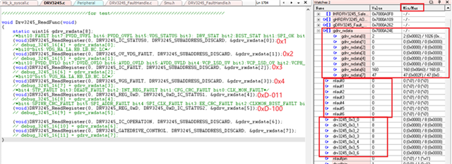

    I read the values of all state registers through an array--gdrv_rxdata[ ], and the debugger interface displayed the maximum and minimum values throughout the entire testing process. The results showed that only the maximum value of register 0x3 had changed, while the maximum values of other state registers were all 0. The maximum value of 0x1 was 1026, indicating that a fault had occurred before.
