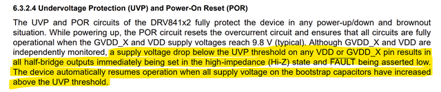

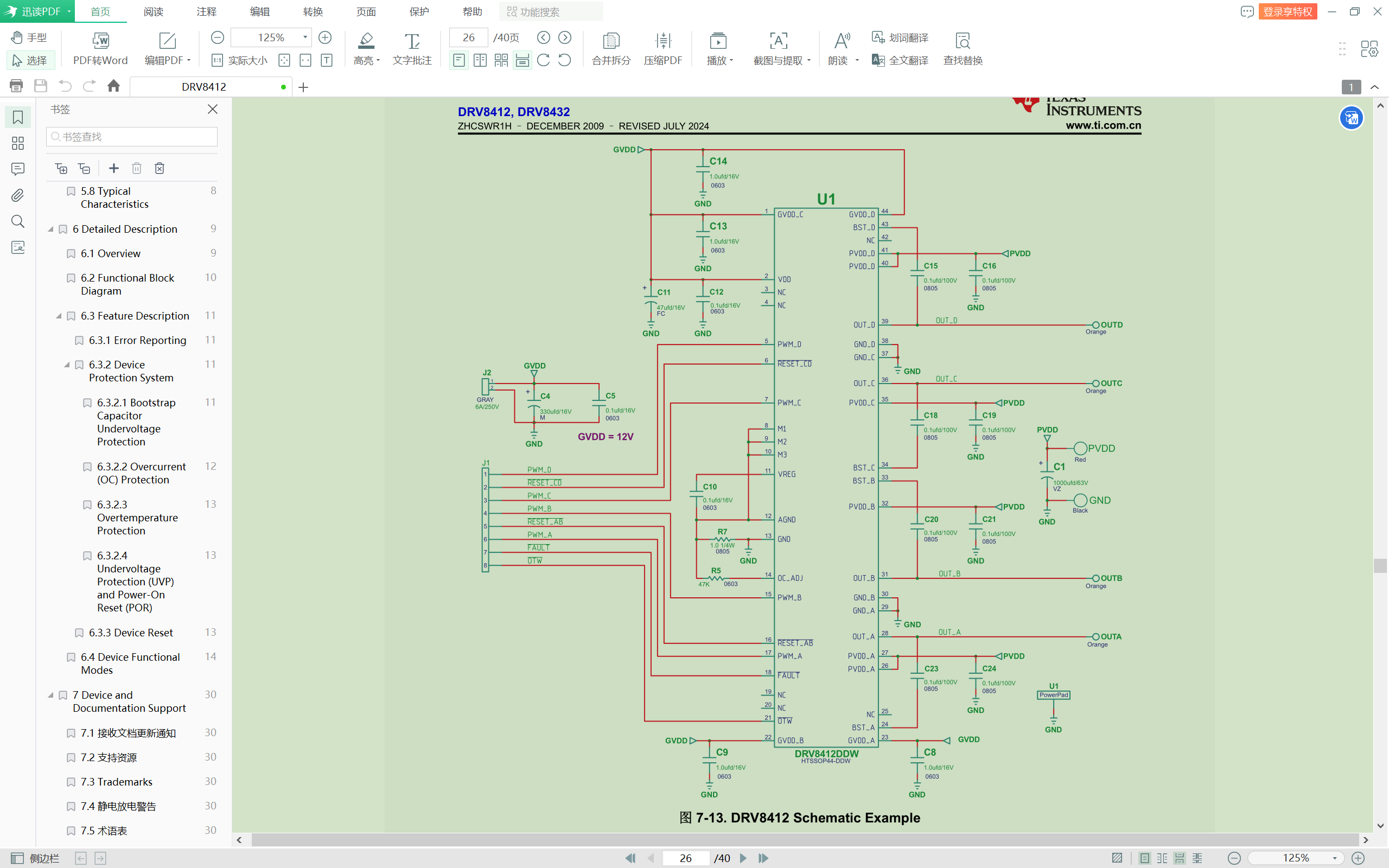

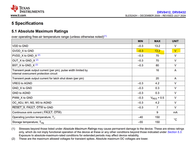

DRV8412: Is there any adverse effect if the PVDD power supply is always on, and the GVDD/VDD power supply is turned on when needed?
