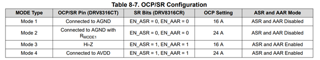

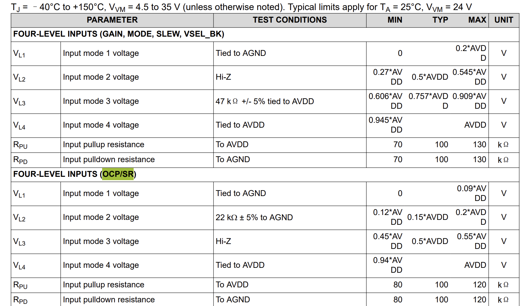

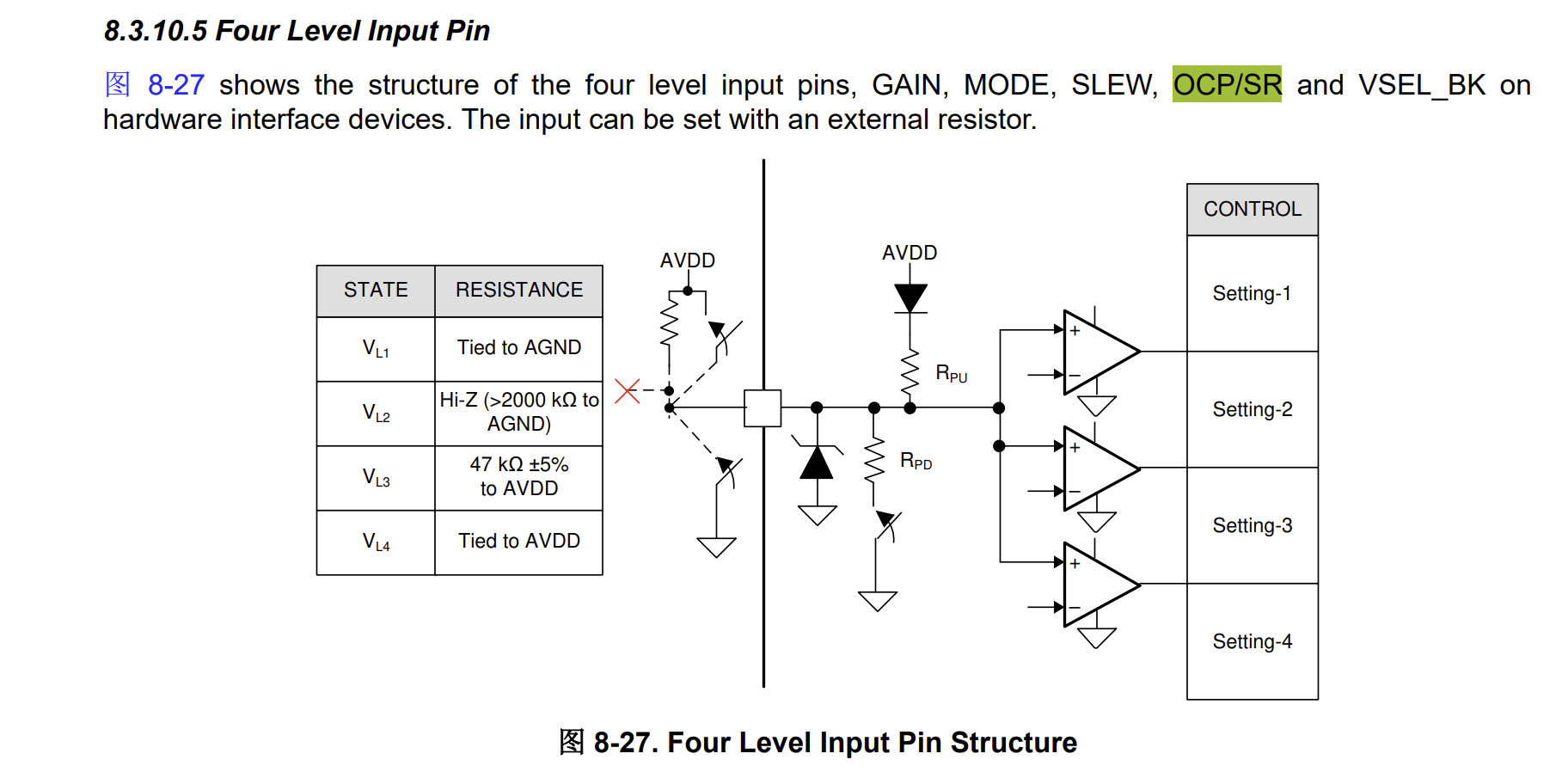

The hardware setup instructions for OCP/SR differ in two locations within the datasheet.
In page 11, OCP/SR setting is different from GAIN, MODE, SLEW, VSEL_BK,(22k to GND for mode2 or VL2)
But in page 38, the settings are the same.(Hi-Z for mode2 or VL2)
Which approach should I take?
