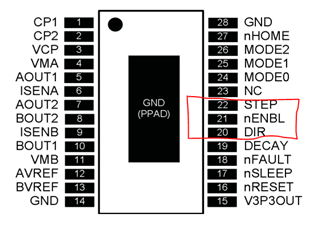

您好请问您是需要我们提供DRV8434P的AIN1/AIN2+ BIN1/BIN2控制双极步进电机的旋转方向和速度?还是您需要DRV8434的表?
如果是8434的话,DRV8434没有 AINx 和 BINx 引脚。 速度是由步进引脚脉冲频率控制的,该频率决定输出电流变化率。

有AINx,BINx。没有DIR/STEP。
也许我们说的不是一个片子?

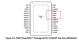

您好,
- 我用的DRV8434PPWPR的引脚图如下:、
- 【似乎贴不了图片?】

I post my question in English for everyone who may concerned reading it seamlessly.
Dear All,
Question: How to control a bipolar stepper motor’s rotating direction and speed with DRV8434PPWPR’s AIN1/AIN2+ BIN1/BIN2 control pins?
I intend to use DRV8434PPWPR to drive a bipolar stepper motor.
When use drivers that have STEP/DIR Control mode, like well know and popular used DRV8825,it’s very clearly how to control the stepper motor’s rotating direction and speed with the IC’s STEP&DIR pins.
When it comes with Control mode of PH/EN-PWM, the means to control the rotating direction and speed(DRV8434PPWPR DATASHEET’s Table 7.3 shows the way to change the rotating direction, though), especially the speed may not be apparently illustrated.
Could you please kindly give me a table like Table 7.3【
DRV8434E/P Dual H-Bridge Motor Driver With Integrated Current Sense and Smart Tune Technology datasheet】, clearly stating how to control the direction and speed with DRV8434PPWPR’s AIN1/AIN2+ BIN1/ BIN2 control pins?

问的是DRV8434PPWPR这款。另贴出的DRV8825是用于举例/对比。
请您参阅以下文档了解如何使用 PWM 接口器件驱动步进电机。
