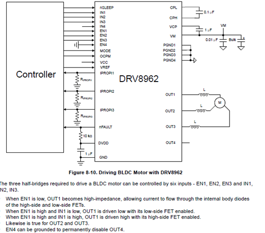

Hi
For supporting a single BLDC, Should  we drive the DRV8962 inputs (IN1..3 and EN 1..3) in the right timing to create the rotation ?
Thanks
Shai

  • Hi,
    Is there a reason you want to use the DRV8962 instead of a dedicated BLDC driver. Can you give me the voltage, load current requirements and if you want an integrated FET and/or control solution, so we can recommend a BLDC driver if you want. You could use this driver, but you have to provide the right INx and ENx signals with an external microcontroller of some sort with the right sequence and timing between the signals.
