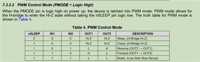

PWM mode control problem in DDRV8874。
According to the datasheet, only fast decay mode is mentioned for the DRV8874. It is unclear whether the DRV8874 supports slow decay mode as it is not explicitly mentioned in the datasheet.
If the DRV8874 does support slow decay mode, could you please provide the truth table for slow decay mode?
