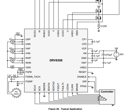

这是datasheet的第44页的典型应用,请您通过您的实际情况做相关匹配,这样避免烧芯片,关于您的参数的问题,请您查一下您实际是这您电路设计值是否进行匹配。

The output of the FG amplifier is provided on a pin, so the gain of the FG amplifier can be set by the user. Filter circuits can also be implemented. Note that the FG signal is also fed back internally to the speed control circuits. The FG signal that the DRV8308 device uses can be generated from a PCB trace under a motor, or it can be input from a logic-level TACH input, or it can be synthesized from the Hall sensor transitions (selectable by register FGSEL). If generated from Hall transitions, the resulting output can be either an exclusive-or function of the three Hall sensors, or the same as the HALL_U input, as shown in Figure 6. Selection of FG operating mode is through the FGSEL register bits. The FGOUT pin is an open-drain output and requires an external pullup resistor to the logic supply.
一个为传感器留的放大比较用的相关端口,具体如何接,请您参考上述描述,关于如何用,可以采集相关传感器采集的数据做相关反馈来达到控制的目的。

请您看一下之前的回复,有相关说明,如果您不用这个部分,您可以使用其他模式,还有datasheet说明有的管脚必须上拉。您参考datasheet说明就可以了。
这个有部分的相关解释说明
https://www.ti.com.cn/cn/lit/ug/slvua41f/slvua41f.pdf
具体说明请您参考开发板的指导书。
