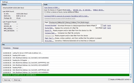

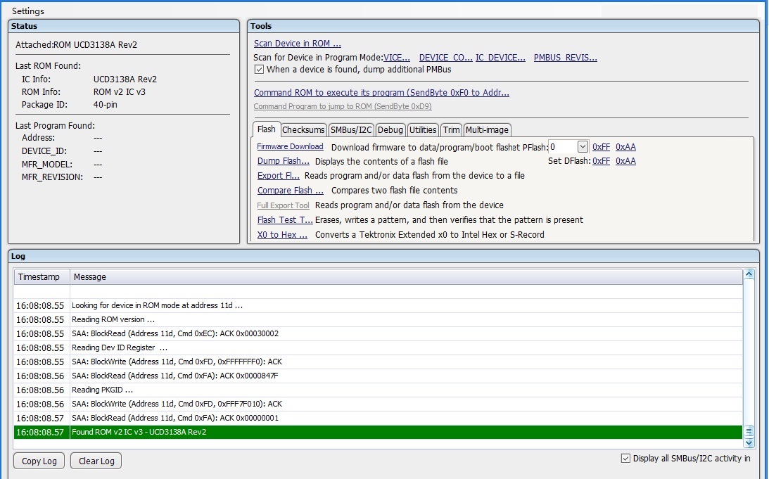

第一次使用UCD3138芯片,焊接到板子上,连接适配器,运行UCD3XXX/9XXX DEVICE GUI程序,能显示控制器版本,但是ADDRESS,DEVICE_ID,MFR_MODEL,MFR_VERSION均无显示;
另外单独运行SCAN DEVICE_ID等命令时,均提示NO DEVICE FOUND,具体信息如下所示。
从手册上看,UCD3138A的地址(PMBUS地址)是AIN0放置了一个51.1K的电阻和3300P电容的并联,然后内部电流源打开时在电阻上形成电压来决定PMBUS地址,我用示波器和万用表都没测量到该电阻上有任何电压值。
请提供指导,谢谢!

| 2016/1/15 15:56:29 | Looking for device in ROM mode at address 11d ... |
| 2016/1/15 15:56:29 | Reading ROM version ... |
| 2016/1/15 15:56:29 | SAA: BlockRead (Address 11d, Cmd 0xEC): ACK 0x00030002 |
| 2016/1/15 15:56:29 | Reading Dev ID Register ... |
| 2016/1/15 15:56:29 | SAA: BlockWrite (Address 11d, Cmd 0xFD, 0xFFFFFFF0): ACK |
| 2016/1/15 15:56:29 | SAA: BlockRead (Address 11d, Cmd 0xFA): ACK 0x0000847F |
| 2016/1/15 15:56:29 | Reading PKGID ... |
| 2016/1/15 15:56:29 | SAA: BlockWrite (Address 11d, Cmd 0xFD, 0xFFF7F010): ACK |
| 2016/1/15 15:56:29 | SAA: BlockRead (Address 11d, Cmd 0xFA): ACK 0x00000001 |
| 2016/1/15 15:56:29 | Found ROM v2 IC v3 - UCD3138A Rev2 |

| 2016/1/15 16:14:36 | |
| 2016/1/15 16:14:36 | Scanning addresses 1-11,13-127 for program mode devices |
| 2016/1/15 16:14:36 | SAA: BlockRead (Address 1d, Cmd 0xFD): NACK |
| 2016/1/15 16:14:36 | SAA: BlockRead (Address 2d, Cmd 0xFD): NACK |
