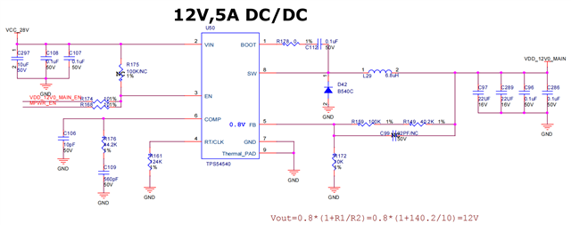

TPS54540: TPS54540 Vin will be pulled down to 4V when the load is higher above 0.7A
Part Number: TPS54540
attach the schematic. the issue is:
1. when the load is less than 0.7A, the Vout is working normally.
2. when the load is higher above 0.7A,  the Vin will be pulled down to 4V, lead Vout can not output normally.
please help to analyze what problem is?
