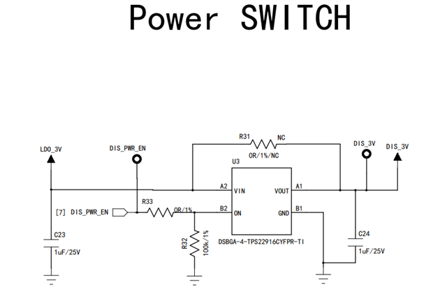

Input: LDO3V
Ouput: display_3V, Irate=2.8mA, Ipeak=35mA.
how confirg input cap and output cap value?
Input: LDO3V
Hello carney,
It depends on the application and placement of power supply from input.
For load switch. We recommend min of 1uF cap placed close to VIN pad. We also recommend CIN > COUT so reverse current won't flow through the body diode during input voltage interruption.
Thanks
Lydia
