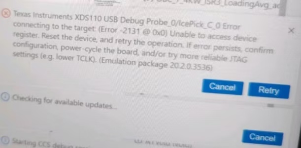

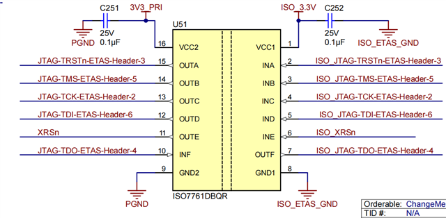

TIDM-02013 (英文)Hello, in TIDM-02013, what is the function of interface J24? When J24 is not connected, the pins of J26 as shown in the figure have no communication input. Will this cause connection error 2131?
Part Number: TIDM-02013
