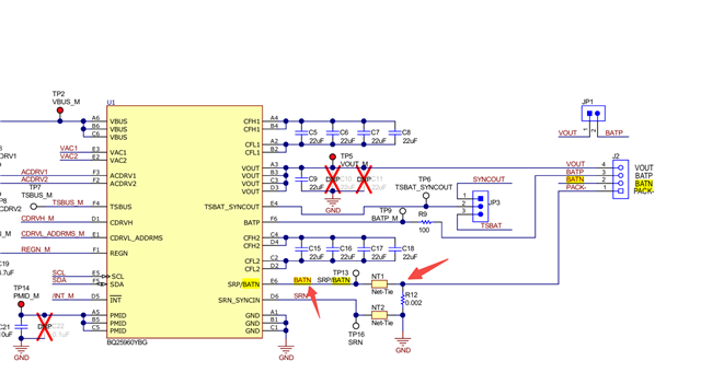

We used two BQ25960 IC,Among them, U1000 was the primary charger, while U1001 was the secondary charger.

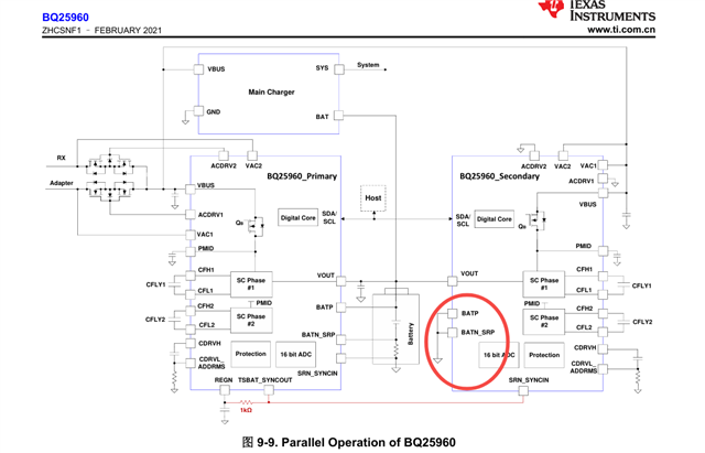

the secondary BQ25960 batp/batn_srp pin connected to the GND in the datasheet but batp/batn_srp pin connected to the battery terminal in the EVM.
1、So, how should this be connected?
2、On primary BQ25960, since there is a certain distance between the current sampling resistor and the negative terminal of the battery, there will be a voltage drop.The SRP/BATN pin simultaneously samples the terminal voltage of the battery negative terminal and the current through the resistance. Whether the detected terminal voltage of the battery negative terminal or the current is inaccurate?

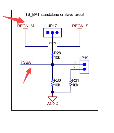

3、Why the secondary BQ25960 TSBAT pull-up power supply  set to REGN_M instead of REGN_S?

  • First, I highly recommend using 2x BQ25960 in parallel by configuring each as a standalone device and controlling them separately, rather than configuring them as primary and secondary devices and using the SYNC pin.
    This approach is the most common way that customers use 2x BQ25960, and we have much better validation coverage for using two devices in standalone mode. Additionally, there’s no performance benefit to the primary/secondary configuration, and almost all protections are disabled on the secondary device in this configuration since they’re handled by the primary device. There’s no need to connect the SYNC pin between the devices when each are in standalone mode. Overall, a dual-standalone configuration is a simpler, more flexible, and better-supported approach.
    BATP/BATN_SRP can be tied to GND on the secondary device, as shown in the datasheet. On the EVM, BATP and BATN of the secondary device are connected to the battery terminals for evaluation flexibility.
    If the negative terminal of the battery and sense resistor are connected relatively close to each other and by a large copper pour, I wouldn’t expect there to be a significant delta between the negative terminal of the battery and the sense resistor. Please note that VBATOVP, VOUTOVP, IBATOCP, VBATADC, VOUTADC, and IBATADC all have associated accuracy specs. For reference, please see the below image showing the BATN connection on the EVM. Please note that the positive side of the sense resistor and the negative terminal of the battery share a copper pour, and BATN is Kelvin-connected to the positive sense resistor pad.
    TSBAT can be pulled up to either REGN_M or REGN_S for evaluation flexibility.

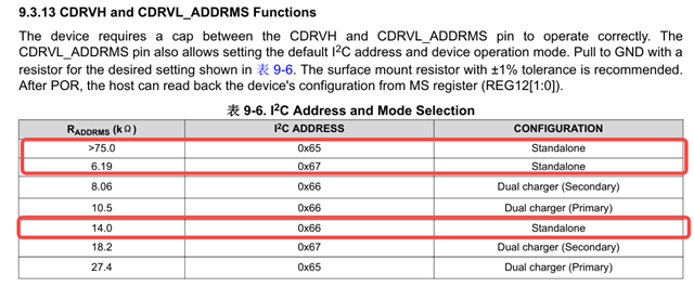

    1、Should the addresses all be set to the standalone mode as listed in the table?

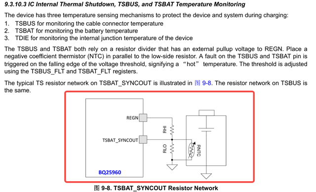

    2、The USB and BAT temperature are read by the platform's main PMIC, therefore BQ25980 TSBUS and TSBAT PIN is possible to be float or some other simple method?

    • CDRVL_ADDRMS of the master has a 6.2k resistor, which sets the master's I2C address to 0x67 and mode to standalone.
    • CDRVL_ADDRMS of the slave has a 14k resistor, which sets the slave's I2C address to 0x66 and mode to standalone.
    Yes, the configuration of each device should be set to standalone mode. This appears to be correct in the schematic. The >75k option can be utilized by not placing an address resistor on one of the chargers.
    Yes, TSBUS and TSBAT can float if not being used, as long as these features are disabled in REG0x0A via I2C.

    4、In order to simplify the layout design,TSBUS and TSBAT PIN float on the master and slave.
    5、Not placing an address resistor on one of the U1000 chargers.

    • REGN is no longer connected to TSBUS and TSBAT on each the master and slave.
    • TSBAT and TSBUS are floating on each the master and slave, as the platform's PMIC will handle these protections.

    you mean using one charger and two chargers, BATP and BATN is any difference in this connection?
    Customers will sometimes only use BATP and BATN on one of the chargers to simplify their design. There is no problem with routing BATP and BATN for each charger, but if your customer wants to simplify their design, they can connect BATP, BATN and SRN_SYNCIN to GND on the other charger. I do not recommend floating these pins.
  • Hi Links
    If connect BATP, BATN and SRN_SYNCIN to GND on the other charger,Will the functionality of this standalone charger be affected since it is unable to read the voltage and current anymore?
  • Hi Links
  • The functionality of the charger will not be affected by tying BATP, BATN, and SRN_SYNCIN to GND.
    This charger won't ever trip VOUTOVP, VBATOVP, or IBATOCP, but these protections will be provided by the other charger. VOUTUVLO and VOUTPRESENT, which are conditions for I2C communication and enabling the converter, are sensed at VOUT, not at BATP and BATN.
