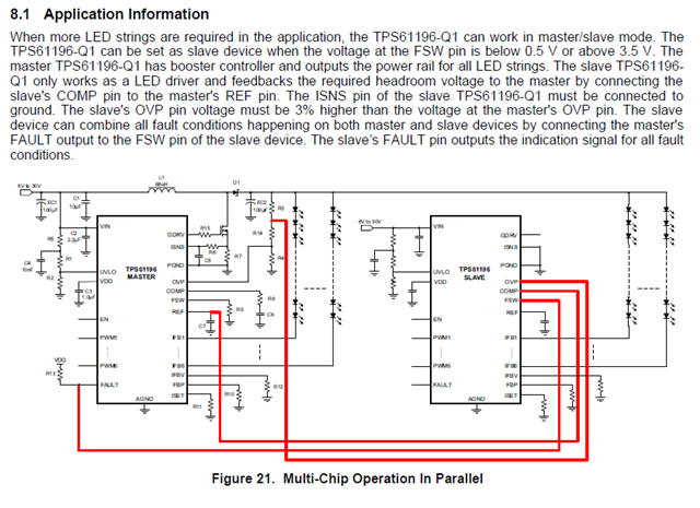

如题,我现在的需求是8路LED驱动,单路最高400mA电流,但是由于TPS61196单路最高200mA,所以我想将两路IFB并联驱动一串LED,这样我就需要16路驱动
根据规格书中的多芯片并行操作,介绍了一主一从的工作模式,扩展到12路
我想知道能不能实现一主两从,扩展到18路

  • 您好
    根据以下原文描述,不建议如此操作
    When more LED strings are required in the application, the TPS61196 can work in master/slave mode. The TPS61196 can be set as slave device when the voltage at the FSW pin is below 0.5 V or above 3.5 V. The master TPS61196 has booster controller and outputs the power rail for all LED strings. The slave TPS61196 only works as a LED driver and feedbacks the required headroom voltage to the master by connecting the slave's COMP pin to the master's REF pin. The ISNS pin of the slave TPS61196 must be connected to ground. The slave's OVP pin voltage must be 3% higher than the voltage at the master's OVP pin. The slave device can combine all fault conditions happening on both master and slave devices by connecting the master's FAULT output to the FSW pin of the slave device. The slave’s FAULT pin outputs the indication signal for all fault conditions
    因为主要电源依靠的是主IC的升压,如您的设计,这个系统不稳定且对于主IC的压力太大。
