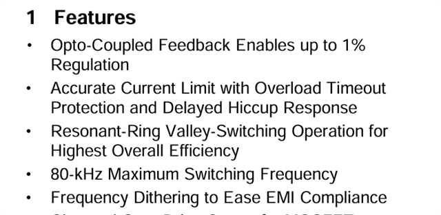

  • 您好,我刚刚查看了该UCC28742的规格表,发现它的最大工作频率列为 80KHz,与您提到的 130KHz 不符。此外,我选择的SiC MOSFET需要20V的导通电压和-5V的导通电压,而UCC51702的数据似乎表明它无法满足这些要求。您能验证一下并告诉我这两款芯片是否可以使用吗?谢谢。
  • 您好,下图是我在查看 UCC28742 数据表时发现的。我有点困惑关于其最大工作频率的哪些信息是正确的。你能告诉我吗?此外,我选择的SiC MOSFET需要20V的导通电压和-5V的导通电压。您能告诉一下哪种驱动芯片(UCC51702 或 UCC5350M)更适合我的电路设计吗?我期待您的回复。谢谢。
  • Hi,
    The maximum frequency is 130Khz:
    This converter uses AM/FM control law to maximize the efficiency over the entire load. So the frequency does vary as a function of the load.

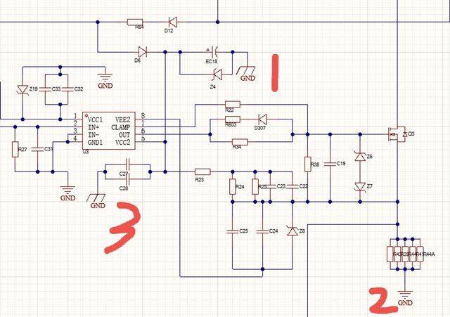

  • Hello Lydia, The schematic diagram below is the circuit design I referenced, which uses the UCC5350M driver chip to drive the SiC MOSFET. Since the chip requires the two sides (left and right) to not share a common ground, the supply voltage of VCC2 is provided by the auxiliary winding. Will it affect the circuit that the grounds at positions 1 and 3 marked in the diagram are different from the ground connected to the auxiliary winding that supplies power to the control chip's VCC? Also, does the ground at position 2 need to be consistent with the ground at position 1 on the right side of the driver chip?
  • Hello, regarding the new question you've raised, it has deviated from the original topic. Please post a new thread to inquire about your new issue concerning the circuit diagram review.
