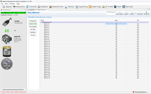

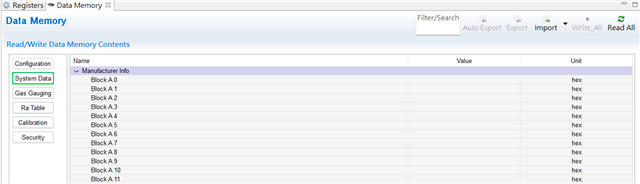

How do I write data into the System Data of the BQ34Z100 and BQ27Z746?
I tried writing, but it was unsuccessful. Are there any additional conditions or requirements for writing?
  • 已经收到了您的案例,调查需要些时间,感谢您的耐心等待。
  • The attached image is a screenshot I captured from BQStudio.
    When I attempted to write, the lower left corner displayed the message: "A read of data written failed comparison."
    At the same time, I’ve also attached the data captured using a logic analyzer.
    write to 0x55 ack data: 0x3E 0x3A
    write to 0x55 ack data: 0x3F 0x00
    write to 0x55 ack data: 0x40 0x10 0x00 0x00 0x00 0x00 0x00 0x00 0x00 0x00 0x00 0x00 0x00 0x00 0x00 0x00 0x00 0x00 0x00 0x00 0x00 0x00 0x00 0x00 0x00 0x00 0x00 0x00 0x00 0x00 0x00 0x00 0x00
    write to 0x55 ack data: 0x60 0xEF
    write to 0x55 ack data: 0x61 0x00
    read to 0x55 ack data: 0x00 0x00 0x00 0x00 0x00 0x00 0x00 0x00 0x00 0x00 0x00 0x00 0x00 0x00 0x00 0x00 0x00 0x00 0x00 0x00 0x00 0x00 0x00 0x00 0x00 0x00 0x00 0x00 0x00 0x00 0x00 0x00
    read to 0x55 ack data: 0xFF
