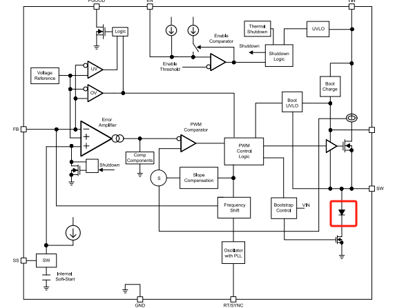

这个二极管在该芯片的作用是什么?一般的同步BUCK无该二极管,且不需要外置续流二极管。
  • 您好
    这个图是内部function,是官方为了方便您理解做的逻辑图。
    The following operating description of the LMR16030 will refer to the Functional Block Diagram and to the waveforms in Figure 7-1. The LMR16030 output voltage is regulated by turning on the high-side N-MOSFET with controlled ON time. During high-side switch ON time, the SW pin voltage swings up to approximately VIN, and the inductor current iL increases with alinear slope (VIN – VOUT) / L. When the high-side switch is off, inductor current discharges through a freewheel diode with a slope of –VOUT / L. The control parameter of the buck converter is defined as Duty Cycle D = tON / TSW, where tON is the high-side switch ON time and TSW is the switching period. The regulator control loop maintains a constant output voltage by adjusting the duty cycle D. In an ideal buck converter where losses are ignored, D is proportional to the output voltage and inversely proportional to the input voltage: D = VOUT / VIN.
    请您参考这部分说明。
