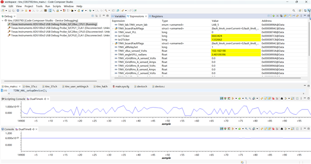

I’m running Experiment 5 on the E6 revision to validate the PLL, with a 30 V<sub> AC source applied. I have three questions:
  1. Why are parameters such as TINV_vGridRms_A_sensed_Volts / TINV_iGridRms_A_sensed_Amps all reading zero? Also, TINV_vBus_sensed_Volts doesn’t change whether the AC source is connected or not—what could be causing this?
  2. The grid-current waveform looks very poor? If I set TINV_reset_PLL to 1, the PLL locks briefly, but after a few seconds it settles to a steady value. What is the reason for this behavior?
  3. I have not implemented the E6 hardware modifications. Will this omission affect my experiment?
