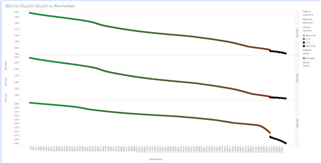

We have designed a 3S3P NMC battery power management solution using the BQ4050. The BQ4050 was configured for the fixed EDV mode with set voltage thresholds for EDV0/1/2. However, during actual testing, the SOC did not get corrected based on the configured EDV thresholds. Instead, it triggered the pack's CUV (Cell Under Voltage) protection while the SOC still showed around 3%, as shown in the attached test data and configuration files. Could you please help identify where the issue might be?

    1st. Make sure your CUV is correct for your application. It might be too high if SoC hasn't' reached 0%.
    2nd. Usually, with CEDV, part will update after you pass the EDV thresholds. The update impacts the FCC. See 6.3 section on TRM

     I looked at your .gg file and data closer. I can see the CUV threshold is 2.9V and indeed, CELL3 reached 2.9V. There seems to be a big difference between Cell3 and (Cell1 & cell2) . Please consider checking for leakages and using cell balancing for your application.

    The observed phenomenon is real-time. We have inspected this battery and found no signs of leakage. The balancing function is also enabled. This is precisely what puzzles us:
    1. The designed battery capacity is 9000mAh/9720cWh, and the design voltage is 10800mV. The abnormal parameters shown in your screenshot were unexpectedly modified by the test equipment during charge/discharge testing. The reason for this modification is still unknown.
    2. As shown in the attachment, why did the SOC smoothing fail to trigger when Cell3 voltage dropped to EDV2/1/0 thresholds? Could this be related to the accidental modification of the design capacity and voltage mentioned above?
    3. According to our design parameters, EDV correction should be triggered when the lowest cell voltage among Cell1/2/3 reaches 3354mV (EDV2), at which point the fuel gauge should smoothly adjust SOC to 9%. When the lowest voltage further drops to 3205mV (EDV1), SOC should be smoothly corrected to 3%. Finally, when the lowest voltage reaches 3000mV (EDV0), SOC should be smoothly adjusted to 0%. However, no such SOC smoothing process was observed in practice. Please confirm the root cause.
    4. The significant voltage deviation of Cell3 compared to Cell1/2 is another point of confusion. We have carefully analyzed the cells and BMS from end-user returns with large voltage deviations but found no abnormal leakage. The capacity differences among Cell1/2/3 are minimal. We also noted that voltage deviations consistently occur in Cell2 and Cell3, while Cell1 has never exhibited this issue. What could be the potential cause? Is it possible that the balancing function for Cell2 and Cell3 is abnormally activated? (Our system is designed to read battery status information every 7 seconds.)

    The SOC smoothing is working as intended.  I double checked with the data log you sent. The SOC reported matches the EDVX threshold you mentioned. The EDVX threshold are to respect to the total BAT voltage, so if your EDV2 threshold is 3354mV then the actual voltage which the gauge will report 9% will be 3 cells * 3365mV = 10095mV. What happened is that the CUV got triggered before the battery pack was able to reach EDV0 which is set to 9V. Last reported voltage from the gauge was 9.56V.
    Based the gg file. The cell balancing did occur on the CELL1 and CELL2, but not in cell3. This could be the issue. Cell3 is not getting time to be balance, so it getting discharge at a much faster rate than the other two cells. The datalog shows how all three cells start at the same time, but they start to deviate overtime. Please try using different cell balancing settings if possible.

    I suspecting the issue to be something else. I was reading the TRM for the bq4050, and cell balancing only happens during the charge of the device, not discharge. Can you double confirm this yourself? I looked over the data you sent, and we can see the difference between cell2 and cell3 was about 50mV when the discharge started, but by the end of the discharge, the difference was ~300mV. I am suspecting there much more resistance on the connectors of cell3.
    Another reason why cell3 might be different is because cell3 is actually older than the two.
