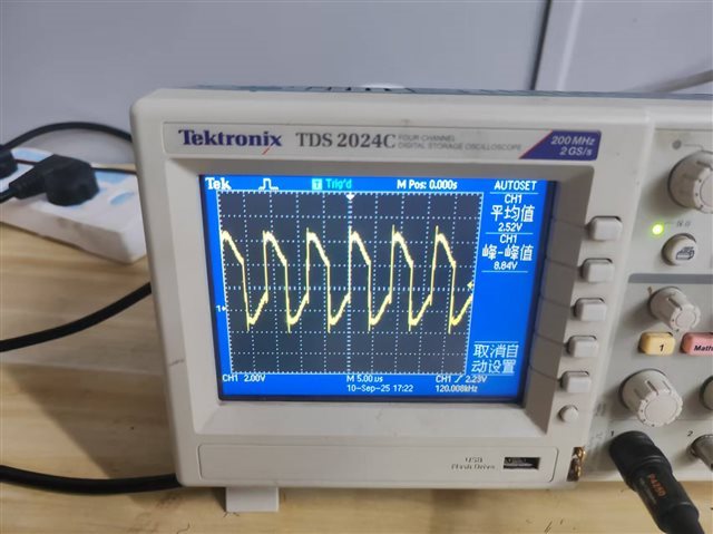

When I adjusted the input voltage from 0V to 10V, I observed that the driving waveform of the upper switch in the GaN PH1 branch was distorted, while the driving waveform of the lower switch remained normal. What could be the cause of this, and would it lead to the aforementioned issue?

    1: However, when I increased the output voltage, the drive waveform became distorted (as shown in the above oscilloscope diagram). Will the distortion of the drive waveform cause the GaN chip to stop working?

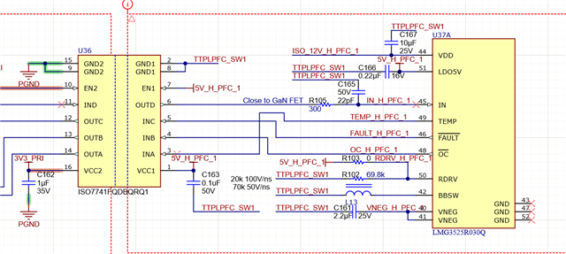

    2: When I connected the oscilloscope across capacitor C165, the output voltage was much lower than the input voltage. When I disconnected the oscilloscope's ground (SW1), the output voltage became equal to the input voltage. I don't understand the reason behind this. Could changes in SW1 cause distortion of the drive signal? Will increasing the capacitance value of C165 improve this situation? Is there a possibility that capacitor C165 is faulty, or could the problem be caused by something else?

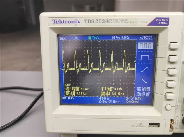

  • This is the waveform diagram measuring the voltage between DC_LINK and SW1. According to the SIMULINK simulation, it should present a square wave. This is obviously related to the distortion of the driving waveform. Could this be the key reason for the failure to boost the voltage? (Since the cause of the fault has not been found yet, no high voltage has been input. The input voltage is 10-20V.)
  • Only the upper transistor, with SW1 and SW2 as the ground, has this problem. The driving waveform of the lower transistor and the voltage waveform between SW1 and IPRI SENSE are correct.

    It depends how your test equipment is connected. If the issue only appears when the scope is connected, it could be that your input source is grounded. If it is when you connect the scope ground to the circuit you short out the input diode bridge.

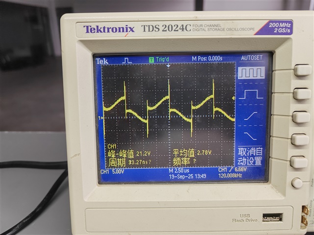

  • In today's experiment, after I replaced U40 and U36, the circuit could normally boost the voltage to around 80V, after which a current breakdown sound occurred. Subsequent measurements showed that when the input voltage was 11V, the output voltage reached 90V. Moreover, the output voltage did not change even after adjusting the duty cycle in CCS, and the following waveform appeared between SW1 and ground. Our team cannot identify the root cause of the problem; we may replace another circuit board later, but we cannot guarantee that the same issue will not occur—and this is exactly what concerns me.

  • I have an oscilloscope, but I cannot connect the oscilloscope's ground to SW1 or SW2. After making such a connection, the output voltage drops sharply and the drive waveform becomes distorted. However, when I do not connect the ground to SW1 or SW2, the drive waveform displayed is correct.I will continue debugging this circuit board and hope to make some progress.

    A scope is essential for this task. You should not connect the scope ground to the switch nodes. Also, you can't connect the ground without first understanding how your test equipment is grounded.
  • I have identified the root cause of the problem. The oscilloscope and the auxiliary power supply were connected to the same power strip, which resulted in the ground of the oscilloscope being connected to PGND. This caused SW1 and SW2 to short-circuit with PGND, further leading to a short-circuit between the isolated grounds at both ends of U36 and U40—ultimately triggering the aforementioned issues. I will replace these two chips and conduct the test again. Thank you for your solution.
