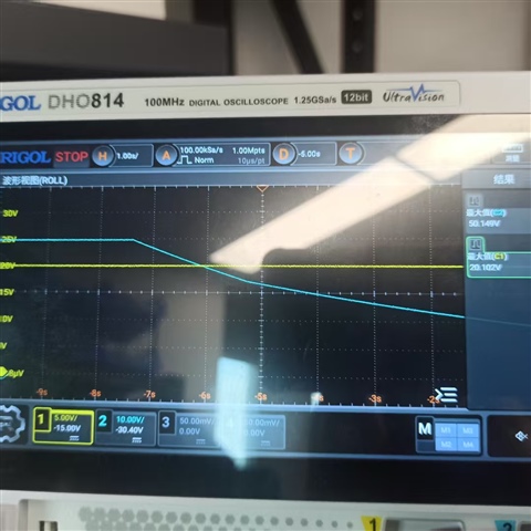

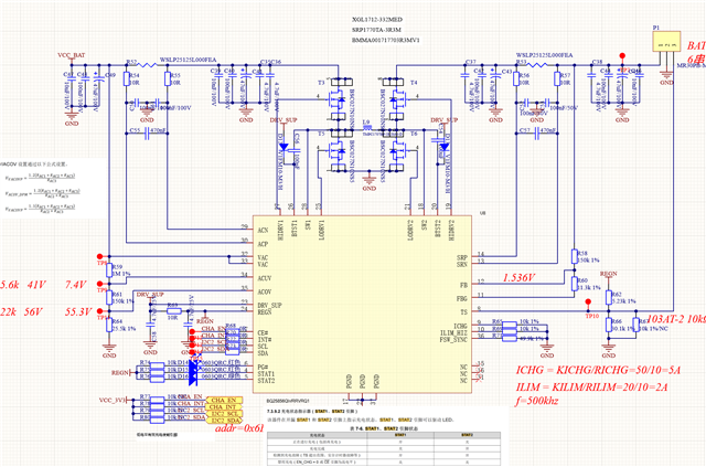

1、After main power removal, the backup battery output boosts to 50V, but sustains only for tens of seconds before dropping to zero. The cause is currently undetermined.
2、Configuration of the auto-reverse function results in charging failure of the device and overcurrent protection triggering on the adjustable regulated power supply
