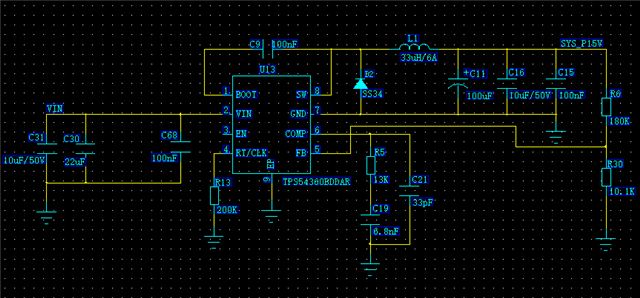

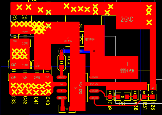

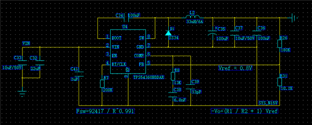

我想用两个TPS54360BDDAR生成+15V/3A和-15V/3A,电路图如下:
电路板上电后,输入电源拉到0.2V,电源CC保护,但是量了一下,电路板并没有短路;
拆掉生成负电压的芯片,正电压正常工作。
麻烦帮忙排查一下,下面是电路板的布局

您好
SWIFTINV-CALC Calculation tool | TI.com
Could you please help with completed QuickStart for the inverting design. It will help us in debugging if anything is quite right in schematic
