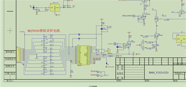

BQ76930单体电压采集第五串单体跳动很大,其他都很好,就是第五串,偶发跳动,挑顶幅度为往20mV左右。各位有为有遇到,电路为TI推荐电路,然后我只链接6串电池:

    Please give me some time to review the schematic.
    When you say the the 'fifth string', do you mean VC5's voltage is fluctuating occasionally? When you measure the pin with an oscilloscope/DMM, are you seeing this fluctuation as well?
    I see in the schematic that this is for a 10S, but you mentioned only using 6 batteries. Are you shorting the cells at the terminal for 6S then?
