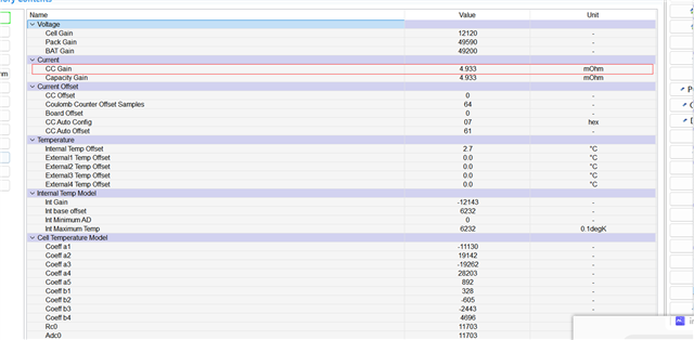

BQ4050 CCGAIN Calculation and Conversion
Other Parts Discussed in Thread: BQSTUDIO

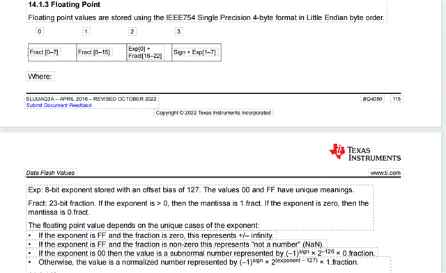

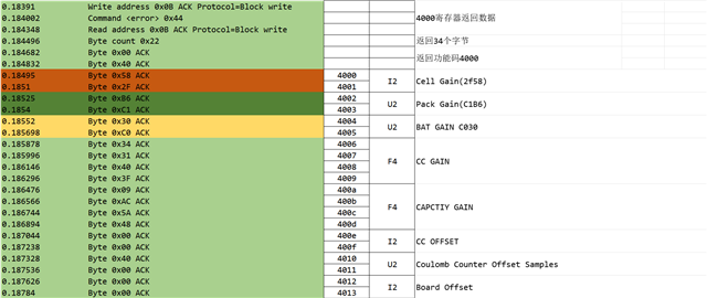

. When observing this in BQStudio, the converted single-precision floating-point value is 4.933, which is inconsistent with the value obtained using the IEEE 754 conversion algorithm specified in the protocol document. Could anyone help explain this discrepancy?
