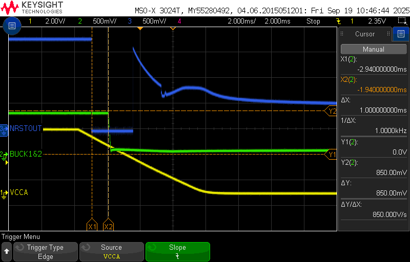

1)During the power-down sequence of VCCA, the NRSTOUT signal initially transitions to a logic low level, followed by a transient voltage spike and a gradual power-off decay. This behavior is illustrated in the figure below. Could you please provide an explanation for this phenomenon?

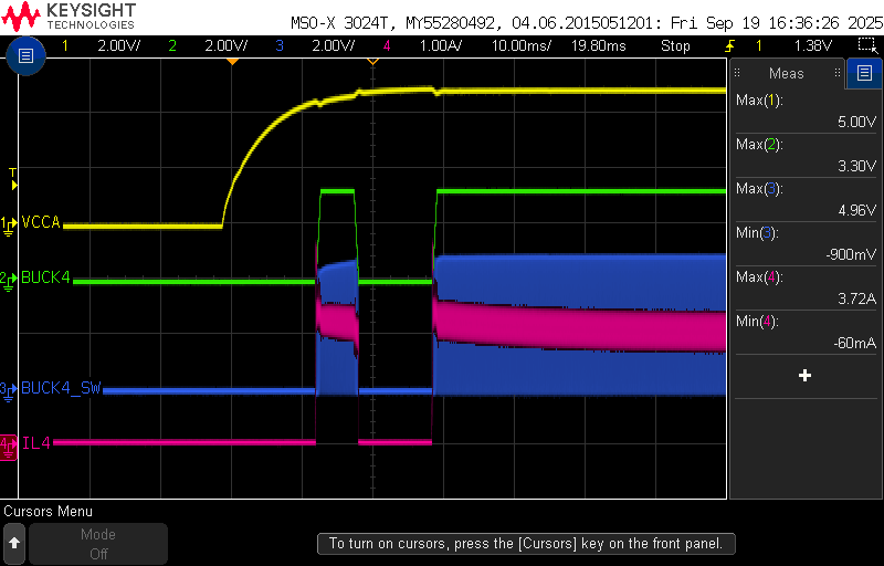

2)When Buck4 is in the output state, if an electronic load is initially used to draw a current of 2 A and the chip is subsequently powered on abruptly, a phenomenon resembling a secondary power-up event may occur, as illustrated in the figure below. Could you please clarify the underlying cause of this behavior?

    1. The nRSTOUT goes high again due to VCCA going under the UVLO level at which point PMIC is completely powered off and can't pull the nRSTOUT pin low. Since there is still charge in the rail to which nRSTOUT is pulled up to it will follow this voltage.
    2. Probably due to VCCA not being high enough when the load is first turned on and the VCCA drops below the monitoring threshold. For more detailed analysis I would need to know the interrupt information, the load rise time and delay between ENABLE signal (or buck4 being enabled) and the shutdown.
  • Hello Taylor,

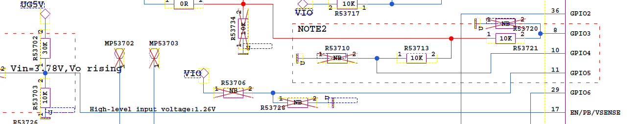

    For the second question, the Enable signal is activated by being powered through VCCA via a voltage divider resistor.
  • Hi,
    Thanks for the info. In this case the PMIC is always enabled before VCCA settles to the stable voltage. Is this scenario possible in the application or could you just wait a bit longer before enabling the load? If in the application it is possible to have the load active before stable VCCA voltage then you might need to alter the schematic.
