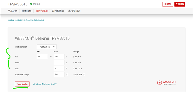

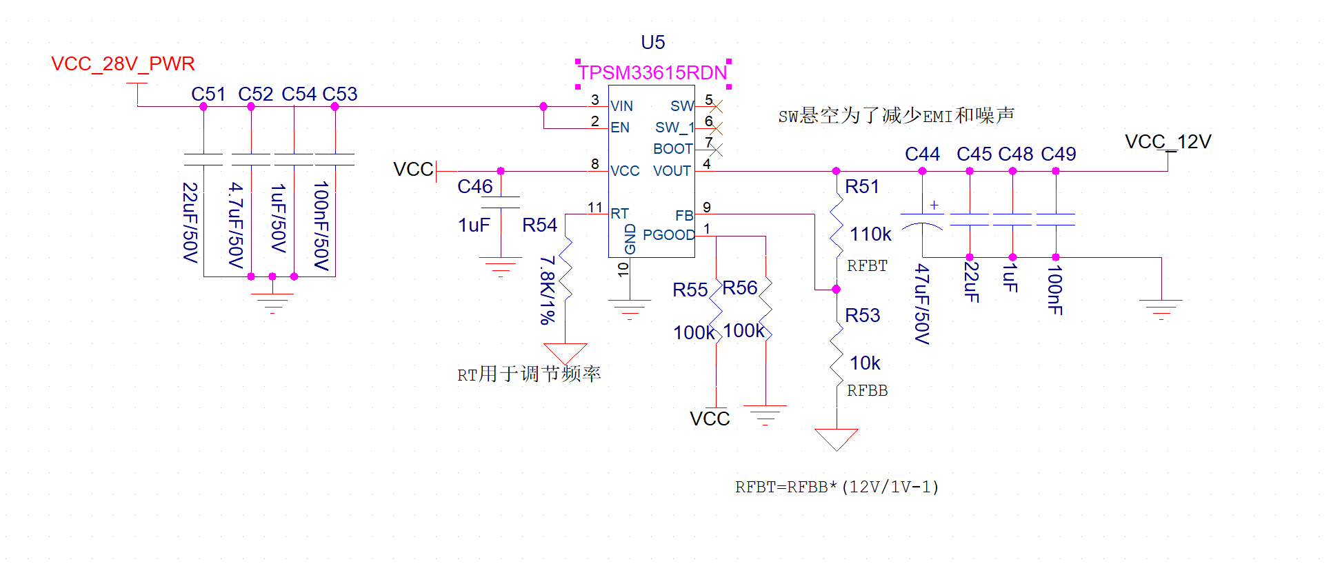

Currently, we need to design a power conversion circuit with an input of 28V and an output of 12V. However, when using the calculator for design calculations, the absence of a model option corresponding to the 12V output has led to continuous failures. We kindly request the provision of the design schematic and PCB packaging solution for this power conversion circuit. Thank you for your support!
