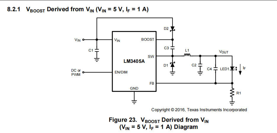

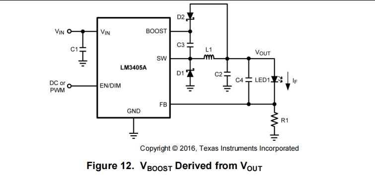

When using LM3405A, my input voltage is "3.8V - 4.2V", and the If and Vf of the loaded LEDs are: 100mA 1.61V, 200mA 1.88V, 300mA 2.14V, 400mA 2.40V. I want to parallel two LEDs, and R1 uses 0.2 ohm to make the output current 1Amax.
Question 1.
Our LEDs' Vf is within the range of 1.6V - 2.4V, not necessarily under full load. Then our LEDs are used in parallel, VOUT = ((n × VF) + VFB) should n also be 1, and Vout is between 1.8 - 2.6. Please confirm if this is so?
Question 2.
① When D2 is connected to Vout, Vboost - Vsw = Vout - VD2 + VD1, approximately 1.8 - 2.6, which may not meet the "Boost to SW voltage is between 2.5V and 5.5V" requirement. As shown in Figure 12.I feel that I cannot use this design reference.
Question 3.
② When D2 is connected to Vin, in this case, Vboost - Vsw = Vin - VD2 + VD1 is approximately 3.8V, which meets "Boost to SW voltage is between 2.5V and 5.5V". Therefore, do I need to use the reference design shown in Figure 23?

  • Question 1.-Yes
    Question 2.:Therefore, do I need to use the reference design shown in Figure 23?-Yes.
    C3 is charged when iL conduct through D1, and is provide power supply for the integrated gate driver for the internal NMOS, If the voltage is lower than 2.5V, the NMOS cannot be properly conducted and there will be large power loss.
    Can you please share what's your end equipment? and what's the LED load architecture? What's the quantity?
