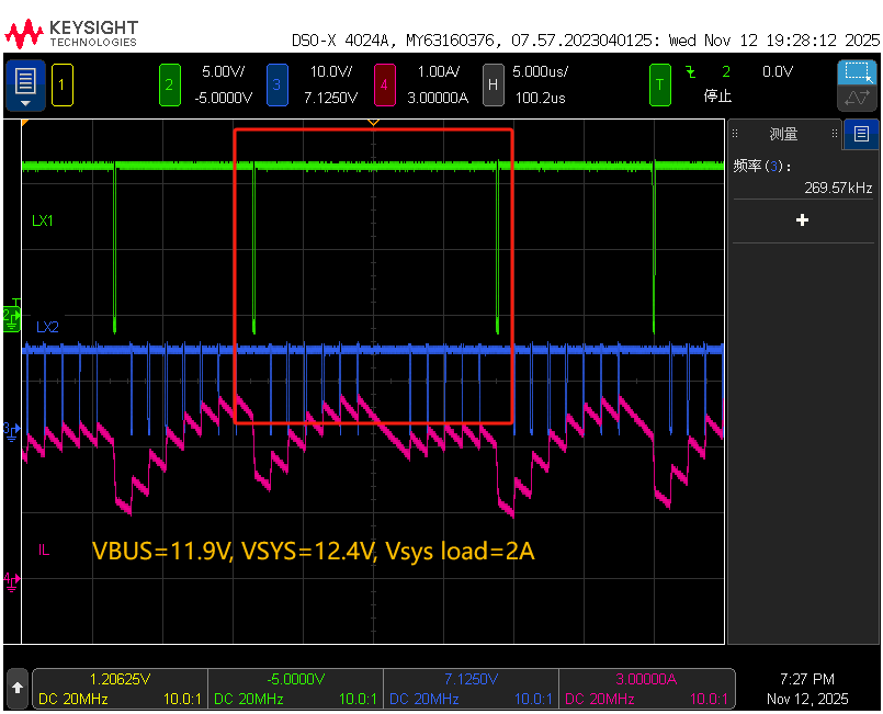

I have a confusion about the BQ25710 work behavior when from boost mode transition to buck-boost mode:

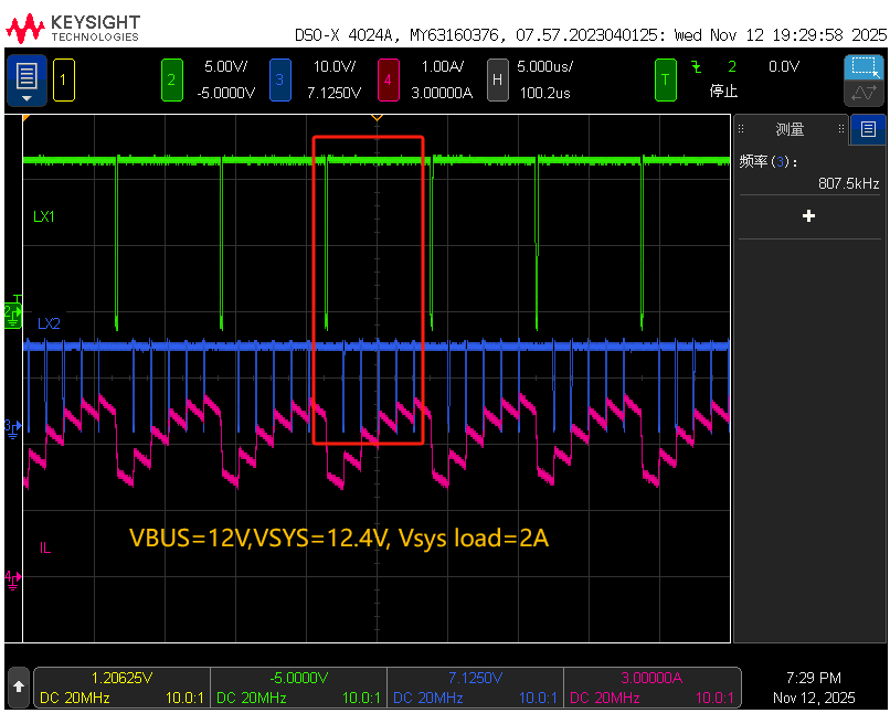

1. VBUS=10V, VSYS=12.4V, Vsys loading=2A, BQ25710 work in boost mode, when VBUS change from 10V to 12V,BQ25710 will enter from boost mode to buck-boost mode,  the waveform below shows that there is one buck pluse and five boost pluses, and the buck&boost pluse is not periodic with vbus voltage change,  I can't understant the actions, can you explain the principle? My understanding is that the switching pluse should is one buck pluse and one boost pluse alternately in buck-boost mode.

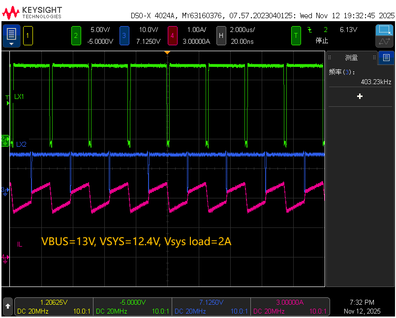

2. When VBUS change to 13V,  the switching pluse  is one buck pluse and one boost pluse alternately, this is correct.
