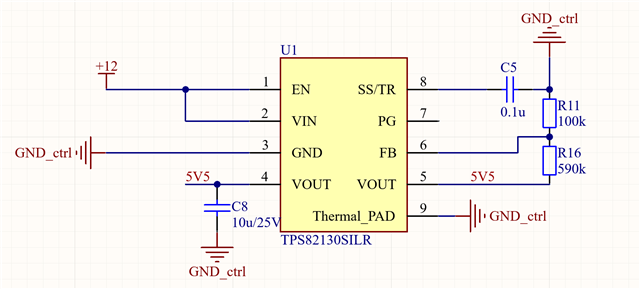

In my design, the output voltage of TPS82130 can only reach 4.7V, the fb pin voltage is less than 0.8V. What may be the possible reason?

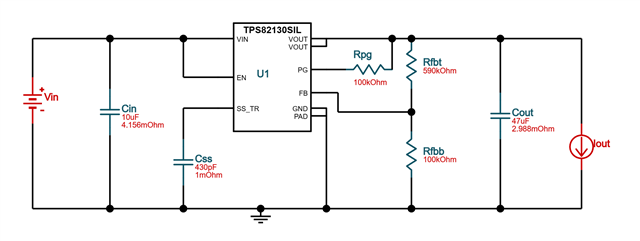

There's WEBENCH® Designer TPS82130 in TPS82130‘s page, you can refer that to design:

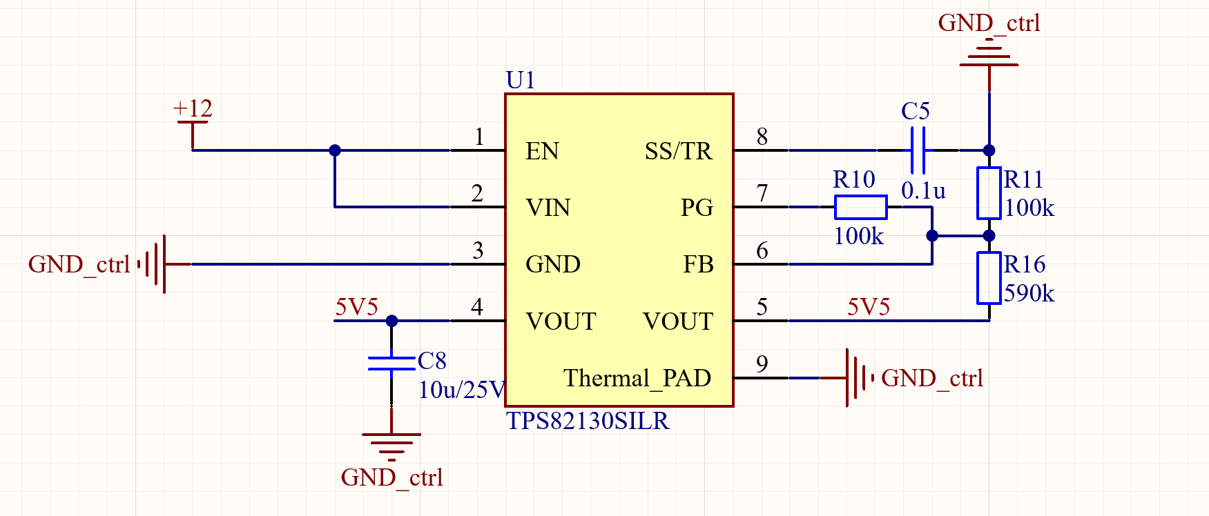

According the latest schematic, is the PG pin floating now?
PG pin 's 100k is connected to VOUT in your webench results
