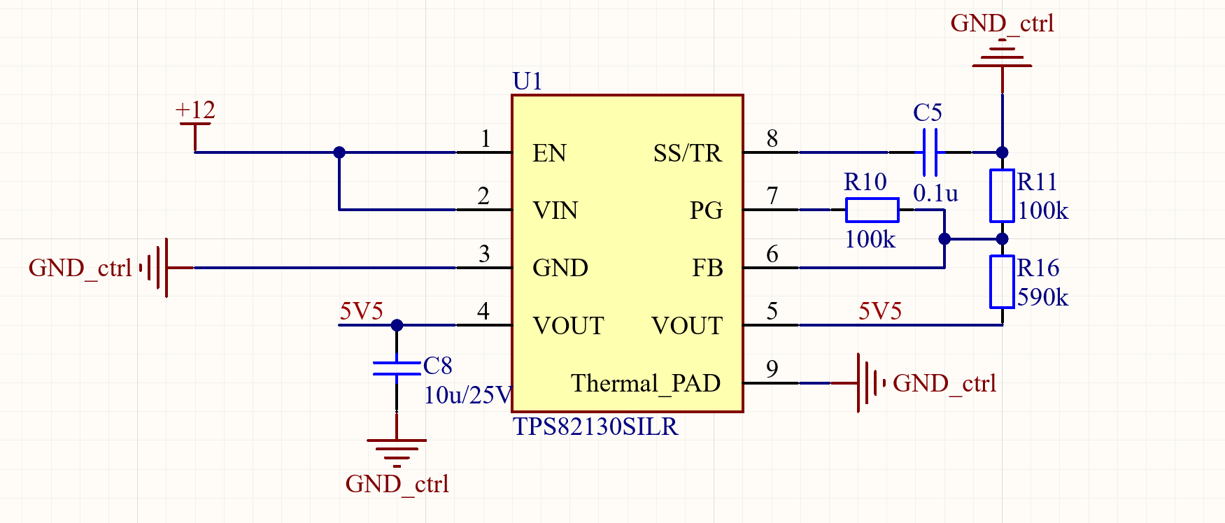

TPS82130: The output voltage of TPS82130 can only reach 4.7V
Part Number: TPS82130
Hi team.
In my design, the output voltage of TPS82130 can only reach 4.7V, the fb pin voltage is less than 0.8V. What may be the possible reason?Snipaste_2025-11-30_16-00-28.png
