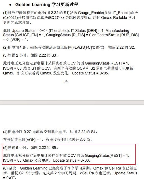

按照手册步骤进行 Golden Learning,一直卡在第5步,update status始终为0x05,无论怎么充放电都无法改变update status,重新烧录和校准也不行。

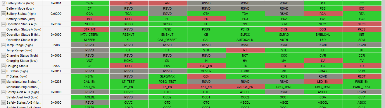

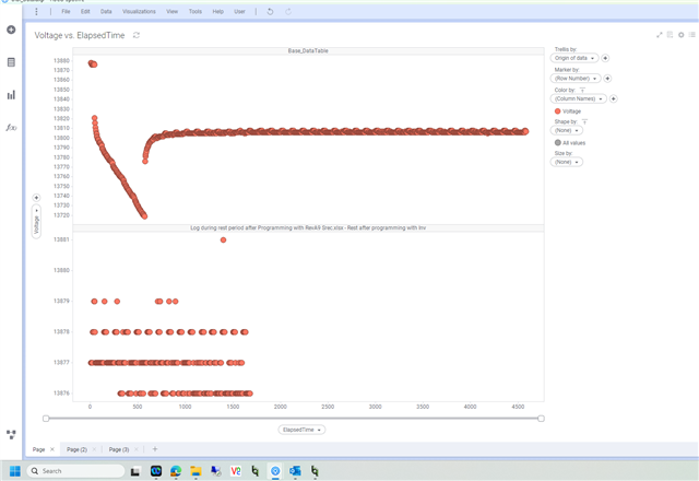

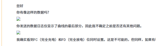

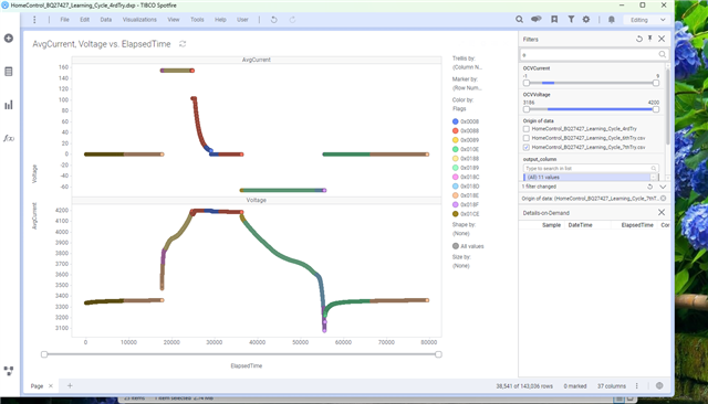

The log you sent me does not have the register values which I need to confirm if the correct bits where set or not:
Make sure they have the following columns:
BQstudio can also create logs as examples if they need one.
