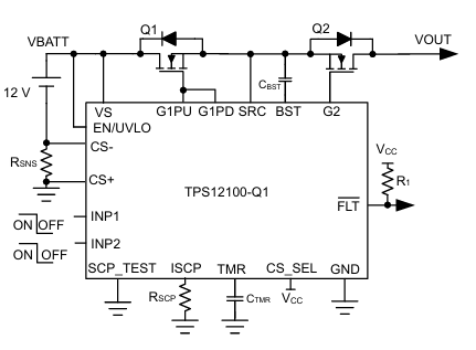

TPS1210-Q1: Short-circuit protection question
Part Number: TPS1210-Q1
Hi team,

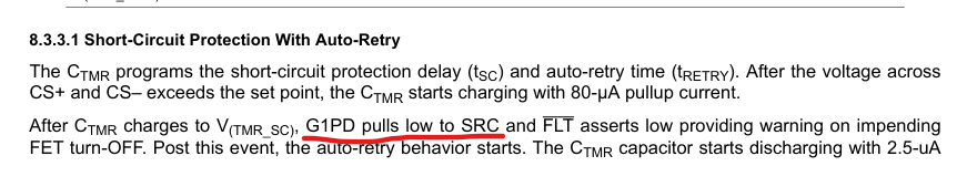

CosMX found the G2 of TPS1210-Q1 would keep high voltage (Q2 keeps on status) when occuring short circuit protection. Could you help to confirm is it expected? And why Q1 and Q2 wouldn't be turned off when triggering SCP? Thanks a lot.
Best Regards,
Ryker
  • 感谢您对TI产品的关注。
    我们正在核实您的问题,请等待我们的答复。
    双旦假期答复会有延迟,感谢您的理解。
  • the pull down of G2 would not help prevent a short circuit as the energy would pass through the body diode of the fet, this could cause too much power going through the body diode of your mosfet causing it to be damaged in the process.
    As only G1 would be able to block the current it is the only one needed to be pulled down in a short circuit scenario
