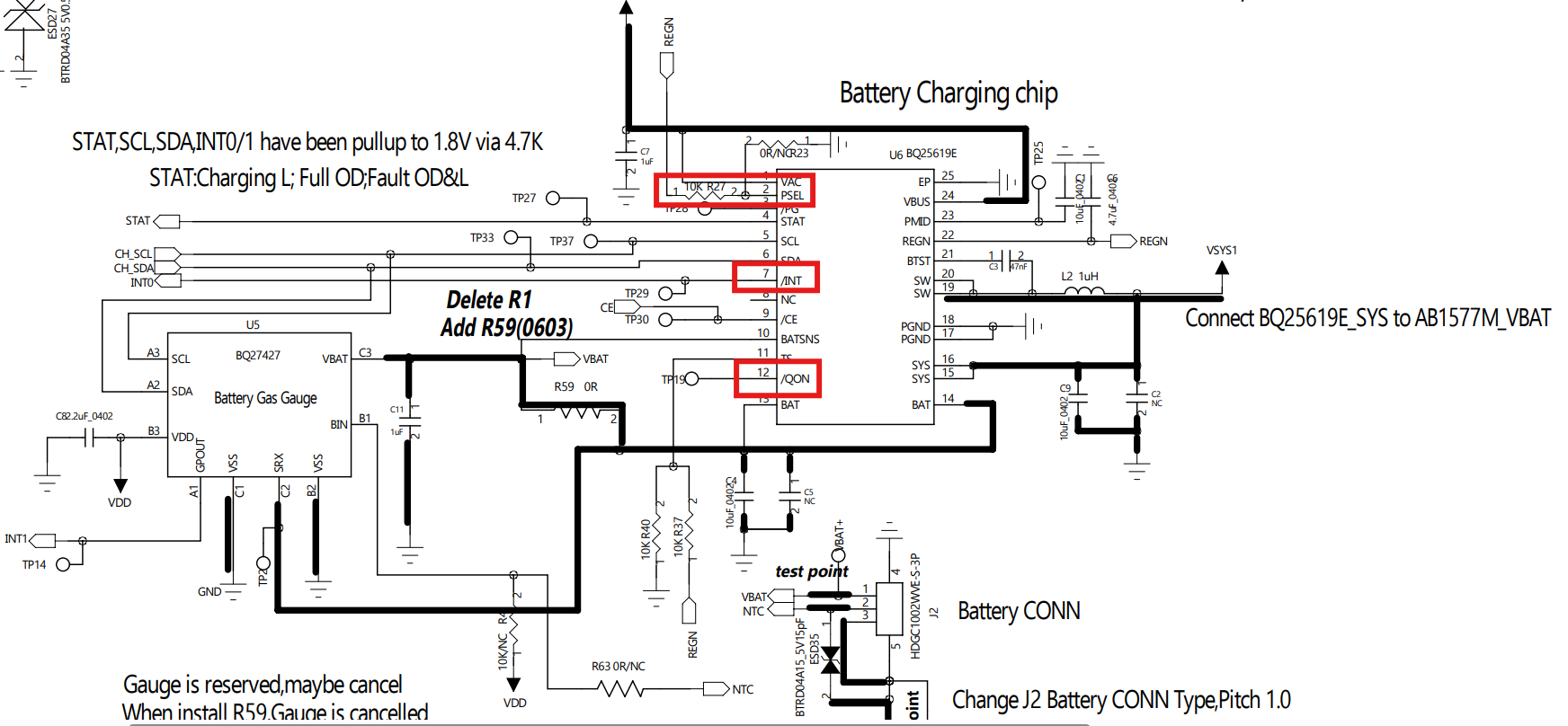

Hi ti team,
请帮忙检查下方BQ25619E原理图是否有问题。另外,有以下几个问题:
1,请问INT PIN在开机后是高电平还是低电平?
2,PSLE PIN是否可以通过电阻接到VREGN?
  • 感谢您对TI产品的关注。
    我们正在核实您的问题,请等待我们的答复。
  • My schematic review is as follows:
    1. I would tie PSEL high with less than 5V as ABS MAX is 7V.
    2. The INT pin is open drain. It is only pulled low when an interrupt is asserted, otherwise it is pulled high through pullup. There are multiple instances in the power up sequences where an INT can happen, check out Section 8.3.3 of the datasheet.
    3. The rest of the schematic looks ok.
