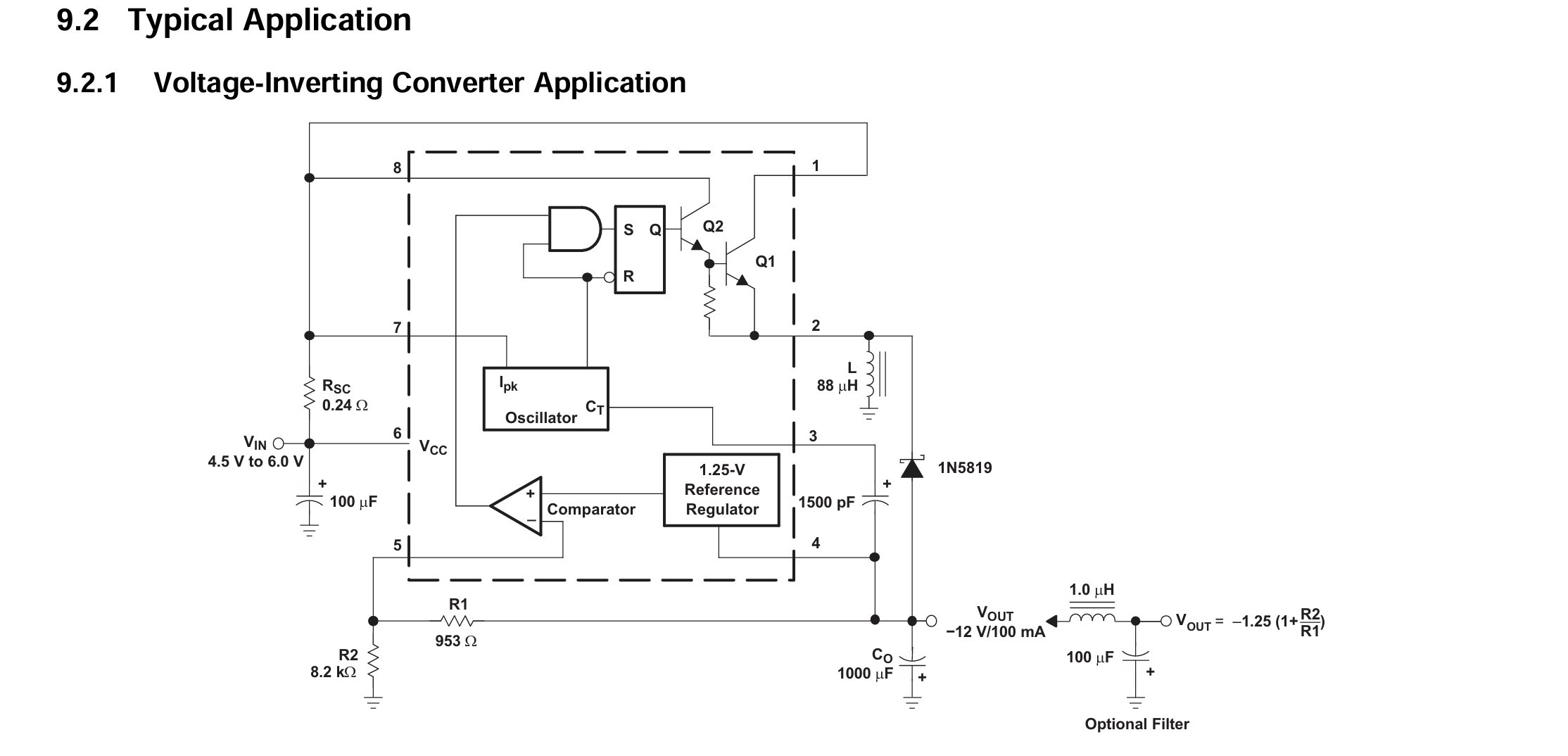

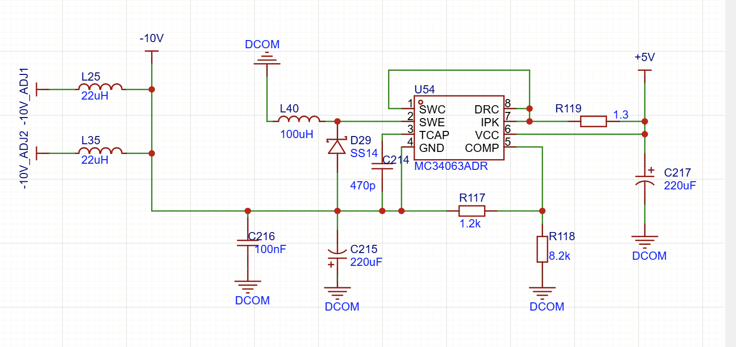

dear expert:
     I followed the instructions in the user manual, but the power supply I converted stays around 4.6V. Could you please advise what the problem might be?I also looked at the forum, but didn’t get any useful information. I hope to receive a response from an expert soon.  I hope you can respond as soon as possible. Thank you very much.
