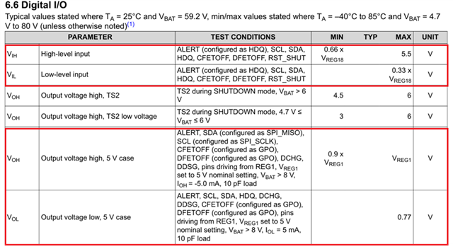

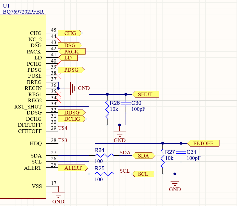

BQ76972: Default logic-level and do i need to connect REGIN/BREG/REG1?
Part Number: BQ76972
From what i understand the ic logic level is whatever reg1 volt is, for the chip im using (BQ7697202PFBR) reg1 is 3.3v by default, i dont need reg1 as i use external buck converter for the MCU, does this leaves logic level to 1.8v, as for reg18, or 3.3v.
Do i need to connect it even if i dont need it to set logic level to 3.3v or for any reason or logic level is already 3.3v.
