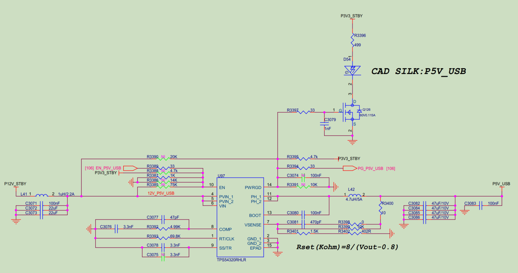

请问TPS54320芯片BOOT-PH电压范围是多少?DataSheet中极限范围是0-7V,在设计中实际测量得到的电压是7.2V左右,这种情况如何改善?
您好, 7.2V的话,没影响,不用管。下面帖子讨论了类似问题请参考。
TPS54320: BOOT to PH voltage - Power management forum - Power management - TI E2E support forums
TPS54320: BOOT-PH DC voltage and maximum voltage - Power management forum - Power management - TI E2E support forums
