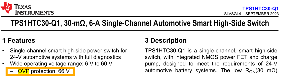

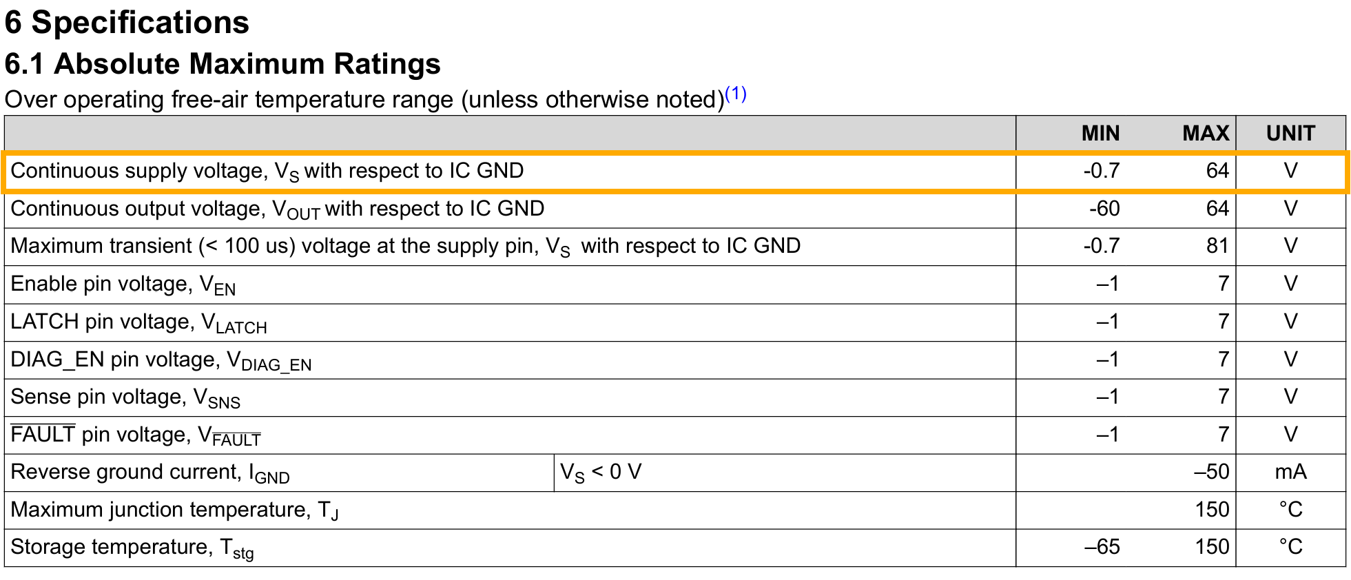

Hi, Team
Our customer Valeo is using TPS1HTC30-Q1 in 48V TMD project.
They want to know if this device can work normally or survive under 70V voltage pulse in Vs-Pin based on ISO21780 test-03(70V pulse with a 10-second cycle and a duration of 40ms per cycle)
It will trigger OVP and the device can be protected?
