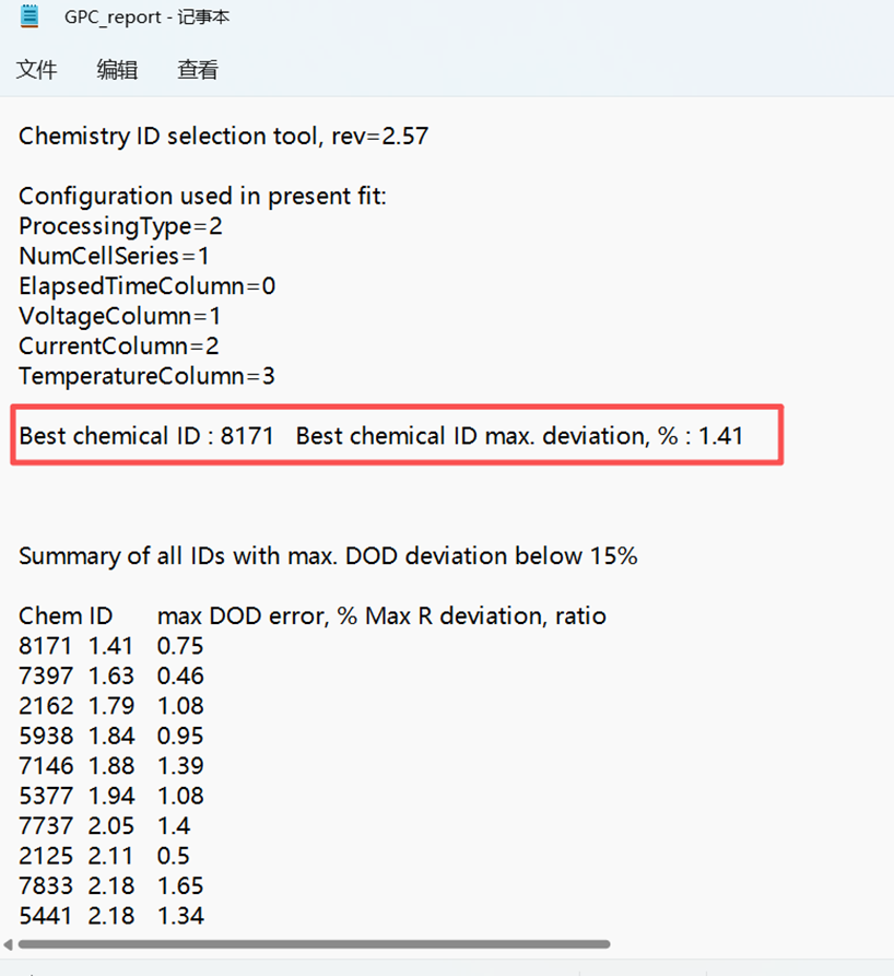

  7. Set the ChemID into BMS, then start the charge & discharge test at high, RT, low temperature
  8. Upload test data and got the Golden file from TI system

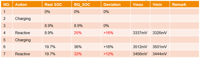

Situation after golden file learning,
  1. SOC can be correct to 100% at end of charge
  2. SOC can be correct to 7% when trigger EDV2
  3. The SOC performance is strange. When wakeup from shutdown, the SOC is not as expected everytime. The deviation is high (up to >15%) when Battery real SOC is low. The deviation is small (~4% = 100% - 96%) when full charged battery and reactive.

  1. How to deal with the ChemID when MCU limit the voltage range from [2.5V, 4.2V] to [2.9V, 4.1V]. Am I correct, or should redo the test based on [2.9V, 4.1V] on cell level for ChemID?
