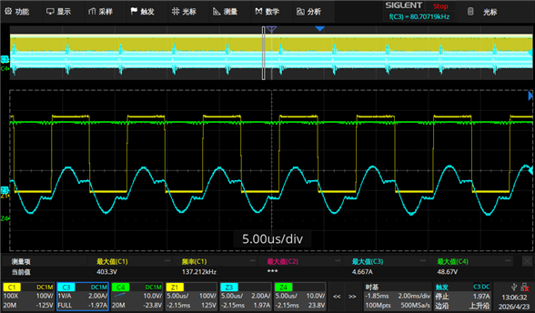

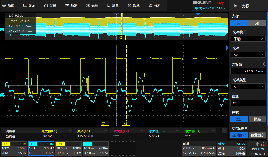

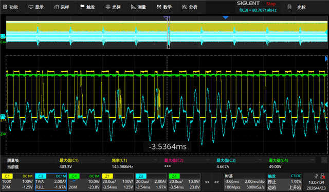

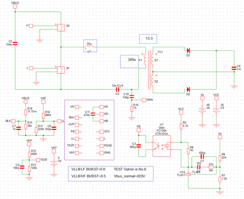

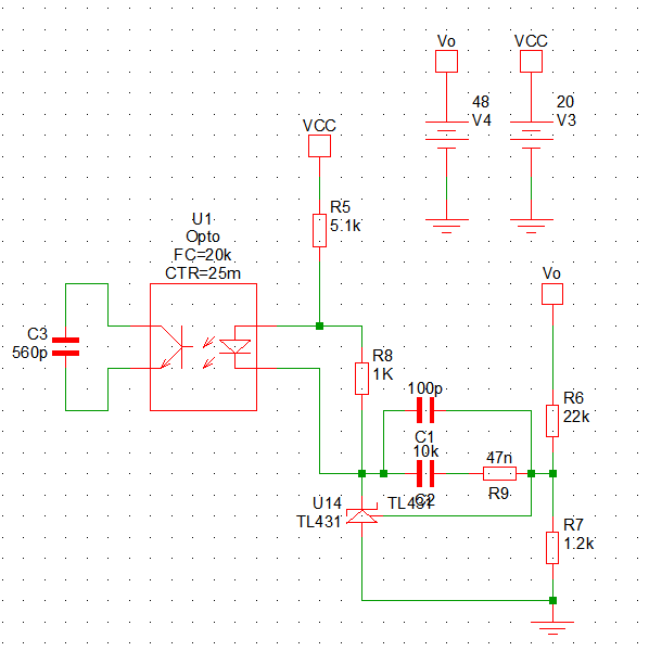

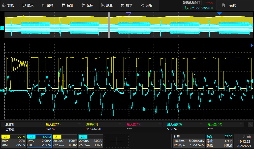

Recently, while working with the UCC25661, I encountered an issue. As the load gradually increases, the power supply exits HF burst mode and is about to enter normal switching mode, during which both modes coexist. Since the hysteresis between HF burst exit and normal switching cannot be manually configured, I would like to ask if you have any good solutions or suggestions.By the way,I also suspected that the issue is caused by the slow loop response, because, as shown in the figure, the current spike occurs at a low frequency. I have also provided the loop parameter diagram I used. Unfortunately, I cannot give the exact value of CTR under this condition, since the current flowing through IF is extremely small. The 0.025 I provided is only an estimated value.

  • Thanks for your reply.I would like to add some additional information.I am not using PFC; the circuit is directly powered by an AC supply.The primary turns of the LLC transformer are 15, while both the auxiliary winding and secondary winding have 3 turns each.The chip I am using is the UCC256610.The parameters for the BLK pin, LL pin, and TEST pin are shown in the figure.I would like to clarify that the brown‑in voltage of the LLC is different from the value in the Excel sheet. According to my resistor values, the actual brown‑in voltage of the LLC is 355 V.Moreover, I am unable to plot the curve between Pin and VFB on my own.What I want to express is that the Pin‑versus‑VFB curve in the Excel file is for reference only.The resistor settings for both the LL pin and TEST pin are identical to those in the Excel spreadsheet.
  • In addition, the RISNS resistor I used is not 150Ω but 75Ω. Since the soft start of the UCC256612 cannot be configured, OCP is easily triggered during soft start when a 150Ω resistor is employed.

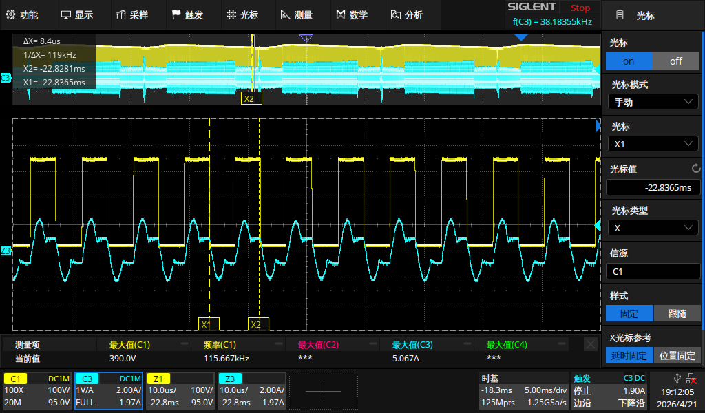

    After further consideration, I suspect the problem may be related to the following factor:Since the unit is directly powered by an AC mains supply, the ripple on the DC bus voltage is relatively large, which leads to the coexistence of HF switching and normal switching.This is because the circuit board is not equipped with a PFC stage.
    Yesterday, I used a 420 V DC power supply to directly feed the DC bus. The captured waveform at full load is attached below, though I am unsure if there is any correlation between the two test conditions; the above is only my preliminary speculation.I currently lean toward loop response issues as the root cause. Unfortunately, I have iteratively adjusted the loop parameters multiple times, yet the problem cannot be effectively resolved.

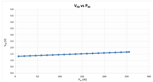

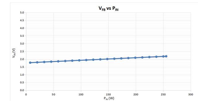

  • Sorry, I couldn’t find the option to upload the revised form. Actually, I uploaded the spreadsheet at the very beginning of this post, though a few parameters in it hadn’t been updated at that time. Would it be okay if I take a screenshot of the FB curve instead?
  • 你好,
    正如我在之前的回复中提到的,上面的图表是平坦的,据我理解,这就是高频脉冲和正常切换之间波动的原因。
    请将 RBLK 的下限值改为 90kohm,然后检查是否还会出现同样的问题?

    请在修改 TSET 设置后分享您的 Vfbreplica 与引脚曲线。

    另外,我的电源是240W的,我的曲线在满载的时候,FB只有2.3V,其实这个值是偏小的对吧,意味着OPP的时候功率会很大。

    你的OPP极限值与你的功率水平相差甚远。
    你需要选择合适的BLK引脚电阻,使得在标称输入电压下,BLK引脚上的等效电压约为4V。(因为UCC256610和UCC256614的扩展增益范围功能已启用)。否则,你的Vfbreplica与引脚关系图将呈直线,并且你会看到控制器在正常模式和突发模式之间来回摆动。

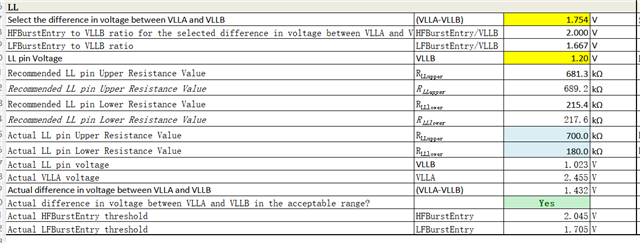

  • "你的系统是否仅在轻负载下以HF Burst模式运行":是的。如果负载更轻,我希望系统会从HF Burst切换到LF Burst。但目前即便是空载,系统也不会进入LF Burst。
    你好,这是我的LL设置部分。我很想知道为什么要把VLLB/LF Burst设置成固定的0.6?这意味着VLLB/HF Burst的值必须要小于0.6,表格里仅有0.55 0.5 0.45这三种选项。

    你需要提高突发阈值才能进入低频突发模式。
    您分享了LO的波形。
    VLLB/LF 内部已固定,以便于选择 LL 引脚电阻。是的,您需要在 0.5、0.55 和 0.45 之间选择一个电阻值,才能同时获得高频和低频脉冲。

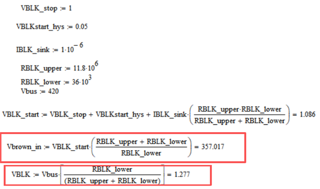

  • Sorry for the late reply. I just got back from the Labor Day holiday, wish you happiness every day.
    Given the EGR function of the UCC256610, does this mean it can support a lower input voltage?

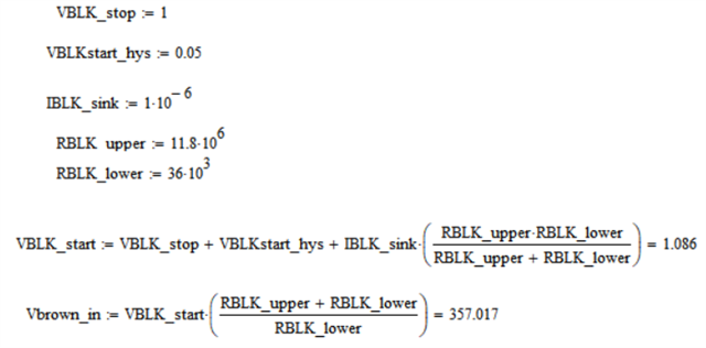

    Really sorry. I still don’t quite understand why the voltage on the BLK pin you mentioned is around 4V. I’ve taken a screenshot of my calculation process for the BLK resistor. Could you please help check where I made a mistake and where exactly this 4V comes into play?
    For the UCC256610,VBLK_stop=1V ,VBLKstart_hys=0.05V,IBLK_sink=1uA;
    RBLK_upper=11.8M,RBLK_lower=36K 。According to the datasheet, the calculation process is as follows.
    Do you mean the voltage of VBLK_start should be 4V?
    Thank you so much for your help these days. Thanks again!

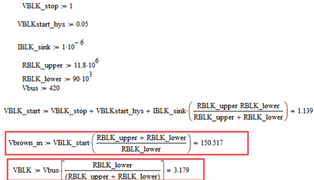

  • What you mean should be: When the PFC is operating normally, the VBLK voltage should be 4V instead of 1.5V. That’s why you previously suggested changing RBLKupper to 90kΩ. The calculations for RBLKupper at 36kΩ and 90kΩ are as follows. However, there is an issue when RBLK is set to 90kΩ: the Vbrown_in voltage will become very low. Will this cause any problem when applied in the LLC topology? The loop gain will be extremely high under this condition.
