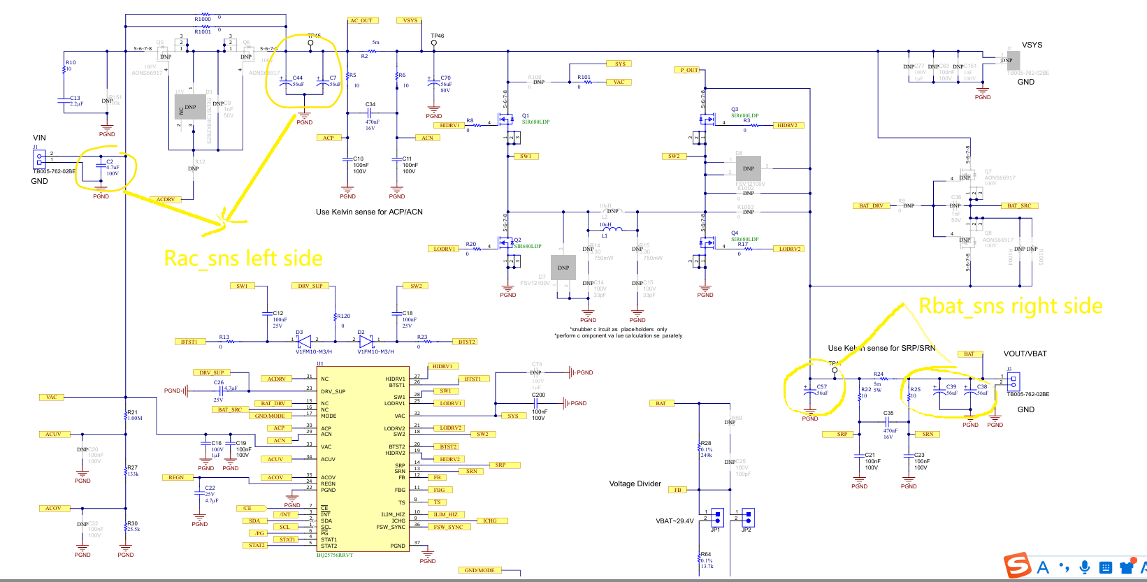

BQ25756: Input (VAC) Capacitor does not distribute equally on either side of RAC_SNS, and same for Output (VBAT) Capacitor
Part Number: BQ25756

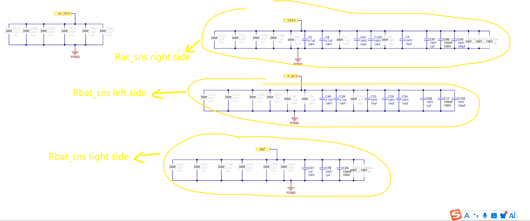

 The BQ25756 datasheet recommends that the capacitance values on both sides of Rac_sns and Rbat_sns be equal. However, this is not implemented on the BQ25756EVM evaluation board.
The total capacitance on the left side of Rac_sns is 116.7 μF, while the right side is 96.5001 μF. For Rbat_sns, the left side measures 96.5001 μF and the right side is 113.101 μF.(Please refer to the picture)
Why does the evaluation board not follow the recommendations in the datasheet?
What considerations led to this design?
 Will this configuration introduce additional noise?
