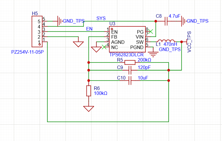

TPS62823: TPS62823. MY output voltage is always 0.2V lower than input voltage, not 1.8v.
Part Number: TPS62823
I am trying TPS62823.

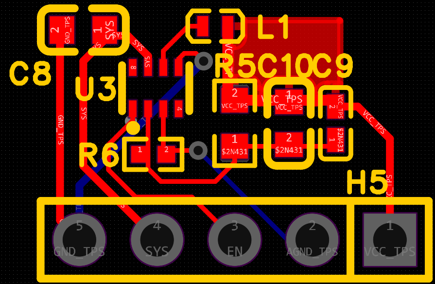

The attachment is my testing board.
I connect SYS and EN to positive on my power supply, GND_TPS and AGND to negative on my power supply.
Output - VCC_TPS is always 0.2V lower then input - SYS. When sys is 5V, VCC_TPS is 4.8V, sys is 4V, VCC_TPS is 3.8V.
Furthermore, when I remove EN, only connect sys on positive. When the input is 5V, the output is 3.4V.
Very strange.
Thanks
